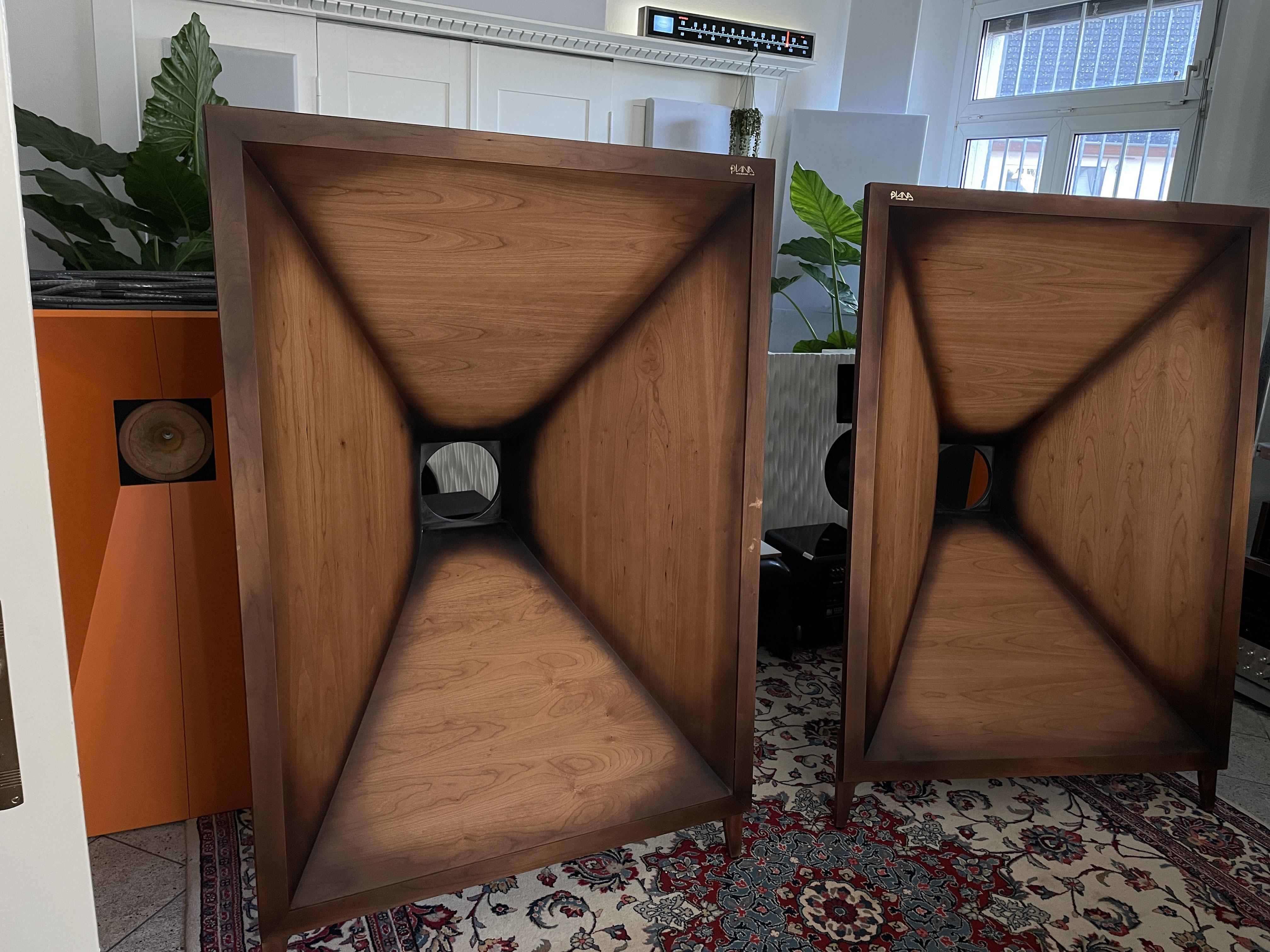

I've heard Rullit several times, but I liked them best on the horn.
At ebay you find such tractrix horns for 8"and 10" fieldcoils
DasguteOhr,
Thank you for your interesting message.
How would you describe the sound of the Rullit's you have heard in the better front horns? Strengths / weaknesses?

I think the secret is that these horns are made of thin wood and resonate. This creates a bit more fullness in the upper bass and midrange. The music these drivers produce simply sounds more authentic. The Rullits have that detailed sound even without a horn, but with the horn it's even more flesh colorful and explosive. Weakness: I don't think every horn on offer plays linearly and without coloration. But that will mainly bother people who run around with a measuring microphone all day. The fun factor is extremely high. I would keep an eye out for old blueprints for tried-and-tested horns for Telefunken field coils.
