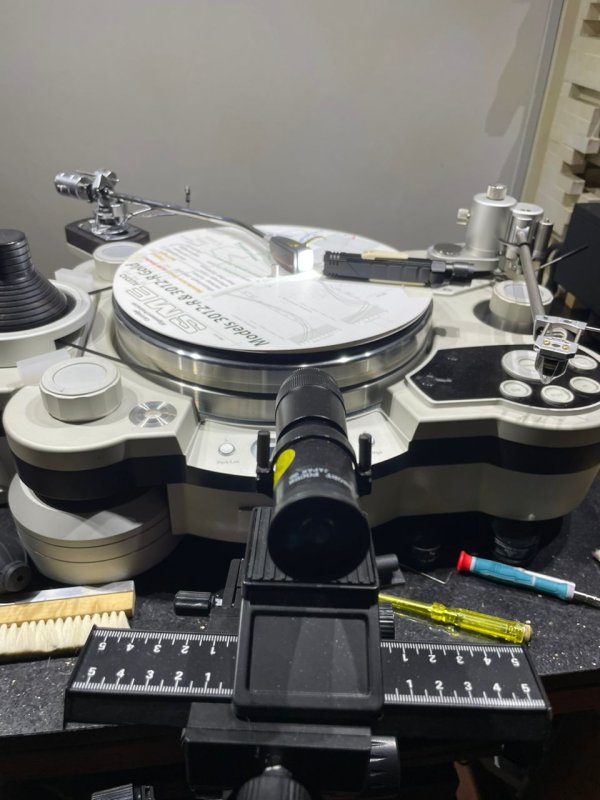

How would you recommend aligning a cartridge where you can barely see the cantilever or stylus because it’s not exposed like the Colibrí and some others? An SPU is quite difficult, and the Neumann was near impossible without the jig. Even my Airtight was difficult on the MINT protractor to get a loop close enough to see if the stylist was on the line.
You can try aligning “ hidden “ cantilever using short focal length monocular . Can even see stylus clearly
Great idea. Does it work on a Neumann? At that angle, can you see the stylus hitting the null point? I would think it is hard to see the markings on the protractor.
eye balling stylus to position it a the centre of the fairly big dot is highly inaccurate as far as I know & the monocular can clearly see the tip of the stylus . Use DDK gauge , counter check with the monocular, I wouldn’t be surprised if it’s not centred at all. I used to set up using original SME 3012R protractor& eyeball it with a handheld scope 10x. I thought it was perfect centre until I used a short focal length monocular to counter check . Try it out .
Don’t have Neumann but I don’t see why not. If handheld scope can be used to set up Neumann, short focal length monocular . Google specwell monocular 10x20 with a diopter to allow monocular to focus at a shorter distance
Reactions: PeterA
U can actually place the scope a few inches away if there is no hindrance in placing the camera stand where the monocular is attached . At least 20x magnification. Few hundreds usd . Worth trying
