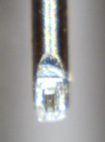

I personally like the Feickert alignment protractor as it will work on any arm and also measure pivot to spindle distance as well. It is more accurate if it has a recess above the pivot point for the pin to drop into though. The Mint is nice because of the mirrored surface that allows you to correct for parallax error when adjusting zenith. I like to adjust zenith by ear anyway because the stylus may not be mounted to the cantilever perfectly square in many cases.

Thanks Mike. I've been lucky with some of those photos. They do give a good idea of what proper zenith alignment can look like. However, as has been mentioned, if the stylus is not squarely mounted in the cantilever, there will still be an issue. I have photographed stylii from below to see this mounting angle. Here is one example:
