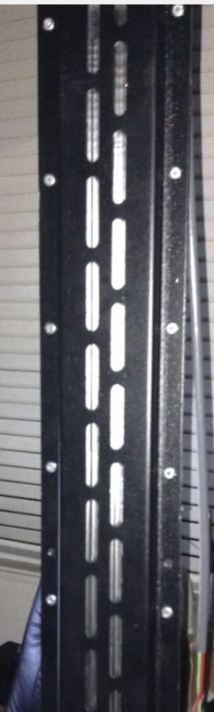

The pair of 75 inchers I have in hand (Bohlender silver sticker and serial number, identical metal fascia to the Pendragons, not to imply they are the same) are neither difficult to drive nor current hogs like Apogees or Maggies (never owned one).
They measure a flat 6 ohms. In my 19x13.5 ft room with 10 to 15 foo ceilings and a 6x8 dogleg in the high ceiling part, with about a 9 foot equilateral triangle listening arrangement, they sound great with every amp I try on them, from a 45 tube flea to 50 watt Wavac to 20 to 25 watt Pass amps to120 watt AV amp.
The 45 tube amp will show signs of stress with loud orchestral, but from 3 watts up on fleas, I can't perceive meaningful clipping at the volume levels I can tolerate. I am currently running them with my DIY Pass single ended Sony 2SK60 VFET amp (putting out about 8 watts class A into 6 ohms) for several months now, and they sound amazing. Crossover is from 300 Hz to 7Khz. I personally would not want to put a bestial high power amp on them, I have opened them up and they are very fragile looking. I have never seen them moving no matter the volume level.
Believe it or not, low to moderate power amps are what I listen to every day when I am with the system.
There is no model number. The ribbons were purchased from a speaker builder who bought them at the Las Vegas Bohlender Graebener factory close out. I bought them from him
Screenshot 2023-03-06 at 10.01.26 PM.pngI use and active crossover, and created a kind of hybrid with the 75 inch ribbons and an Analysis Epsilon speaker. Each frequency range have their own drivers and amps. The 75 inch ribbons have their own amp.Screenshot 2023-03-06 at 10.51.14 PM.png
The last picture is Pendragon, you can see the fascia look quite similar on the ribbon portion.
