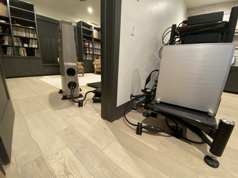

Hi Peter, just one more thing out of the room. I remember how well your smaller room sounded when I visited a few years ago. Overall, I like the sound of this room MUCH better. The Artnovian stuff did wonders. About the only thing is the super deep bass maybe isn't as deep as in the much larger former room. However those bass traps are tunable, so I have a lot of experimenting to do on the bass nodes.
I did not change speaker cable length (6ft) from the former room. So the amps are still very close to the speakers (and a hole in the wall). I did have the amps in the room at first and prefer this arrangement. Those Nagra amps are tall and extend into the center midrange area and were sending off some funky reflections. See below:
Hello John, yes it’s surprising how good sound can be in a small room. You visited me right after I got the big SME turntable. Things have changed a lot since then.
I think our rooms are about the same size now although your ceiling is much higher. I was wondering about those transparent speaker cables but the holes through the wall are a great solution. It’s a nice clean look to have the rack in a different space also. It’s nice to read about your system in the new place.

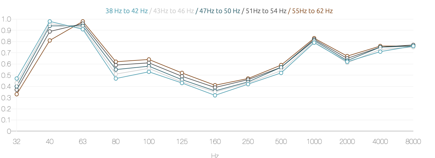

These are the tunable sub traps I have on the other wall corner (3 of them):
https://artnovionassets.blob.core.w...68/Eiger_Sub_Trap_-_Corner_Technical_File.pdf

Great stuff! So just so I understand, you have corner traps that work around 32hz up to around 50hz or so. Simple question: one sets up a room without any of these...thinks 'its pretty good'...and then someone put this sub bass trap into 2 corners. What happens?
I am not suggesting it instantly makes everything better...the whole set up has to be calibrated. My question is simply 'what does the subtrap actually do'? Most interested!
What happens? First I take out a entire corner of reflections, cleaning up a lot of the sound stage. As for the bass, took out lumpiness, added texture, delineation and over all deepens what I am hearing plus making the mids much more enjoyable. They are clearly addressing some room nodes...
Also, they are not "just working" from 32-50hz. That is just their maximum absorptive range.
