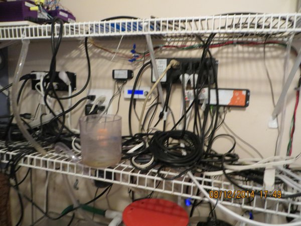

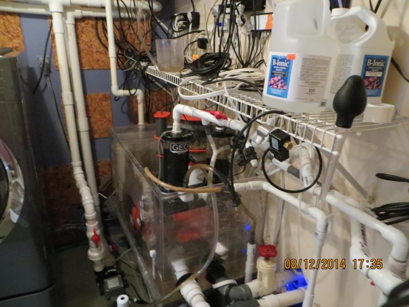

.My main goal is to make it more maintenance friendly so I will be able to keep on top of things better, which putting it downstairs will do.Greg,
