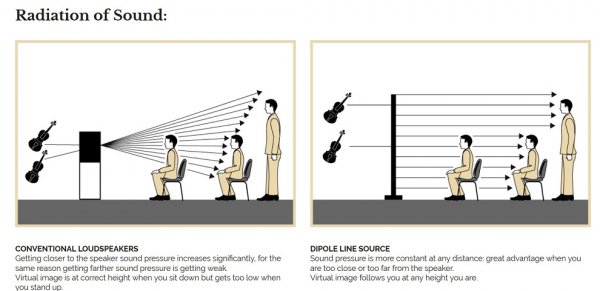

Todd, how does using a planar speaker affect this?
I have a Martin Logan hybrid speaker.
Similar radiation pattern to the below I assume.
https://alsyvox.com/our-technology/

planer speakers is something i have limited experience with so I can’t answer with certainty. But first order reflections are almost never good. Acoustic treatment is pretty cheap and east to experiment with. I always suggest get a couple panels, put them on the ceiling and let your ears be the judge —especially if you have a ceiling less than 10’.
Well I'm no Todd, but I've spent many years with line-source-approximating dipole speakers (SoundLabs).
A line-source-approximating speaker has very little interaction with the floor and ceiling, as shown in the diagram you posted. If you take that kind of speaker and toe it in enough that it effectively misses the side walls, now you have virtually eliminated the early sidewall reflections as well. If you can also pull your dipole speakers about five feet or so out in front of the wall, then the backwave is arriving after a long enough time delay that it doesn't degrade the clarity or tonality or imaging, but instead is overall beneficial.
Not that these are the only things that matter, of course.
