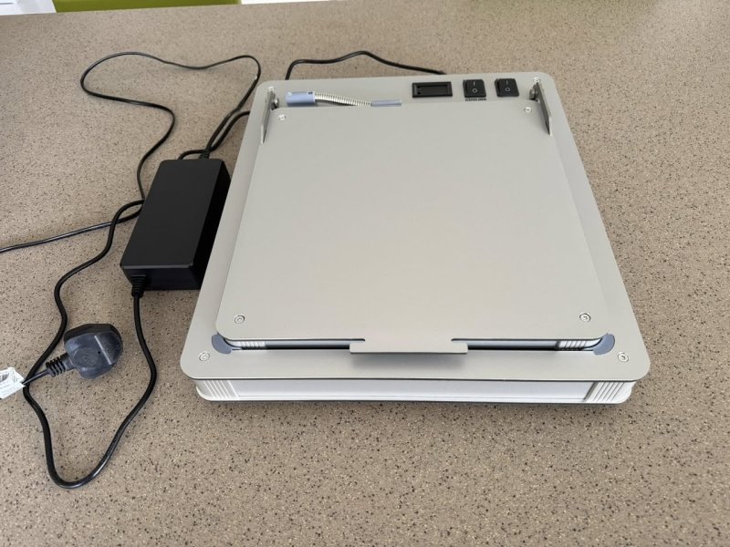

After a long wait, supplies of the Pro-Ject Flatten-It vinyl record press have now reached the UK.

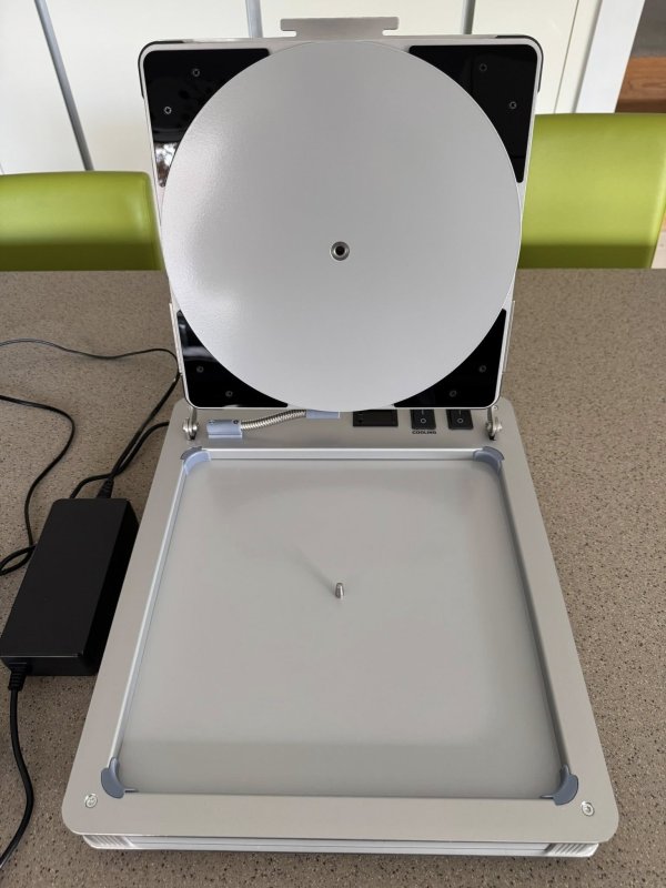

Back to the Pro-Ject Flatten-It. UK distribution through Henley Designs. UK model, designed to be used with UK mains out of the box. Extremely well constructed and finished, with simple instructions for use and priced at £749.

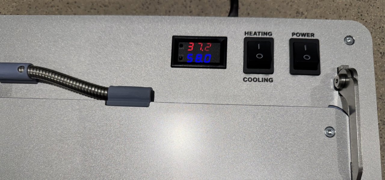

I followed the set-up instructions and allowed the machine to cycle through it’s first heating/cooling phase, without a record, to check that the temperature stabilised at between 56-58 Celsius and did not exceed 60 degrees, indicating possible damage in transit.

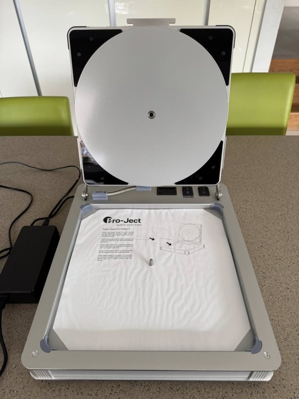

The machine has an On/Off switch and a Heating /Cooling switch. The manual advised cleaning any warped record first (so into my Degritter MKII they went), allow to thoroughly dry and insert into the paper sleeve supplied, before closing the lid and switching the machine to Heating mode.
After an hour, the temperature stabilises around 58 degrees Celsius and the complete cycle with a 180g vinyl record will require two hours of heating, followed by switching to Cooling and allowing the temperature to slowly fall to around 30 degrees, before removing the vinyl record from the machine.
