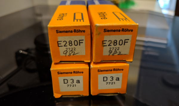

Update on the silver Slagle, since @CKKeung asked. I think it has settled in nicely. I ended up adjusting a few tonearm parameters and eventually swapped from E280F to D3a tubes in my phono stage. The end result works very well now with the silver AVC.
Are E280F and D3a interchangeable?
If you are asking for your Incito ,since bias is adjustable,yes:) Same family,as with E282f,E180f,E810f ,etc.Now which one is better,that is debatable :)

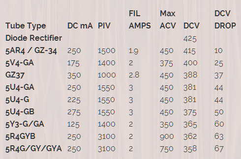

What interests me even more, what rectifier tube types I can roll in my wonderful Incito?
Is 5u4g possible?
Replacing the 5ar4 with others like the one mentioned, would be downgrade.The 5ar4 has about one forth of the voltage drop of these irregardless of the brand used.It actually has the lowest voltage drop of the conventional rectifiers ...you can however use another 5ar4/gz34.
I think yours have Japan made one ,which were based on the GE design.you can try Philips /Rca which sound different for example.
If you use 5u4 ex. you will end up with higher voltage sagging -different operating point.

Yes. E280F and D3a are interchangeable in my phono. They present quite differently in my phono stage, and I seem to prefer D3a with the silver AVC but preferred E280F with the previous copper AVC.
Can you try and describe the Sonic difference between E280F and D3a?
Well, this is going to be specific to my phono, and it's always the entire circuit design that creates the final sound...
And to be clear, I do like both tubes, so I'm trying to describe differences I hear, not necessarily positives vs negatives. Briefly... I found the E280F to be a bit more technical. It's giving a more precise sound. Some might say analytical. I wouldn't go that far. It highlights treble a bit more, and it highlights bass. It's very neutral in the midrange. Its soundstage is more forward. I found the D3a to be slightly dark in the treble comparatively. I'm still trying to decide if I'd consider it dark in an absolute sense. Bass is also a bit less highlighted. Midrange is very similar with D3a (maybe?) slightly sweeter. D3a soundstage extends further back behind the speakers, i.e. less forward. I'm not sure how accurate this deep soundstage is just yet. Both tubes can be punchy when called for, but overall D3a is a bit more relaxed. E280F seems to highlight micro detail more. This could be due to its more forward nature. Again, I'm not entirely sure which is more accurate.
Horses for courses. I'm stockpiling reserves of both tubes.

Here is a nice chart,note the vast difference in voltage drop(the lower the better)View attachment 50200
Thank you for that very helpful chart.
What Voltage drop would a SolidState rectifier have?
Probably a very low one.

@christof A solid state would have no sagging that depends on current draw,like a tube rectifier would.but I would take as well tube rectifier all day long against SS.however not all tube rectifiers/diodes sound the same.wait till you leave tube rectifier realm and step into damper tube diodes, gas rectifiers etc:):)
@christoph A solid state would have no sagging that depends on current draw, like a tube rectifier would. but I would take as well tube rectifier all day long against SS. however not all tube rectifiers/diodes sound the same. wait till you leave tube rectifier realm and step into damper tube diodes, gas rectifiers etc:):)
