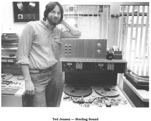

Several known professionals were using the Cello Audio Suite with P603 directly wired to tape heads in the 90's, as reported in the "Cello Professional Equipment" leaflet. https://www.matthew-james.net/Customer-Content/WWW/CMS/files/Cello-Prof-Audio-Equip_v3.pdf.pdf Does anyone know if they are still using them?
