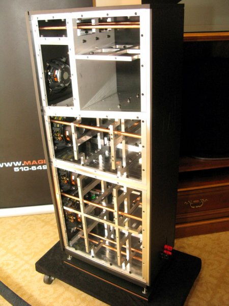

We already showed you quite a few images of the speakers you questioned first (but you are obviously the type of guy who dispute an image as well :(). Here is another one, btw, clear as it can be, not that I think it will change your mind:
We've seen that, and I said it doesn't look like the midrange is hermetically sealed, mentioned holes in the plates, etc; then we shifted to the S5 MkI and would like to see a picture of that. But I think I am done with this discussion, as I have better things to do, and I am sure so do you.
I don't think we showed you this one (You are so locked in your position, are you even looking at what we are sending and saying??), it clearly shows the different compartments. I don't see any holes here, and I can assure you they are hermetically sealed, as said, they will not work otherwise. BTW, if you are still not convinced, email or call Magico, I am sure they will be able to clarify things for you (or maybe not even :().
