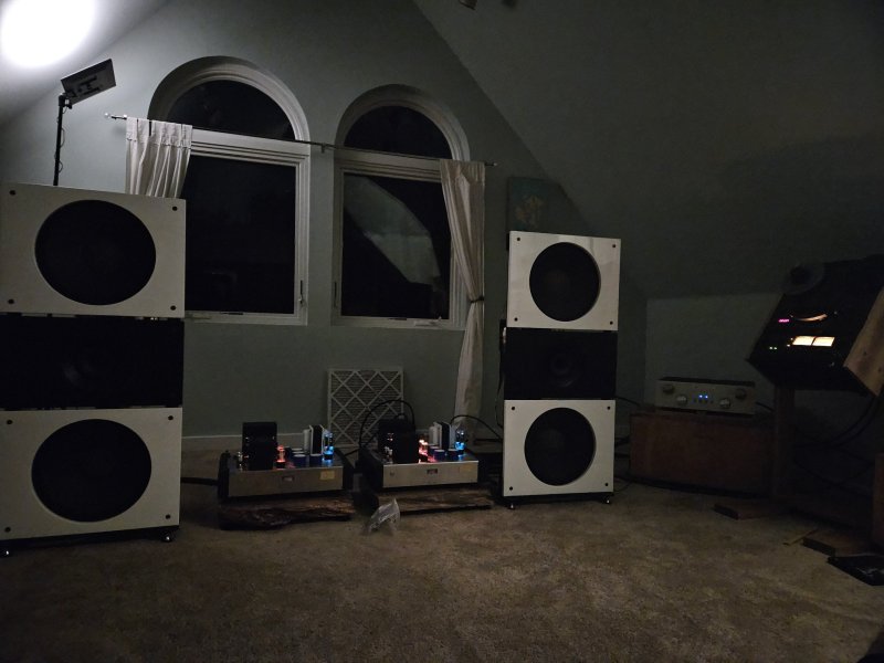

Listening very near field. Thrown on the floor. No real setup. Sounds pretty good. Enjoyjng some tapes. Its going to take a while to get vinyl seup. I also have to get ethernet and real power to the room. The pre is in a plug with 12 awg. No idea the amps.
They’re looking good in that space already Rex.
