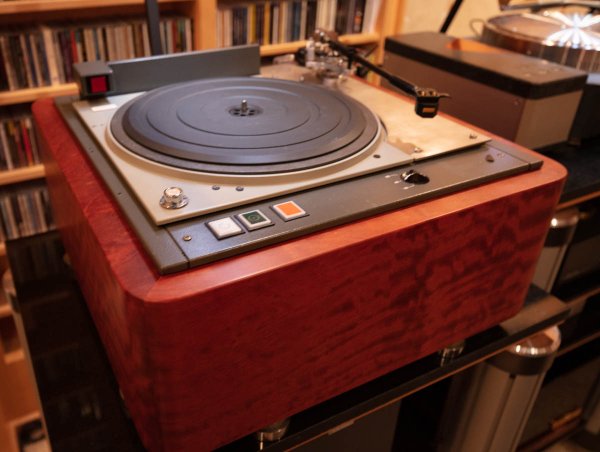

Monday my new Adona GXT rack (my 4th ) arrived for the EMT 948/Kairos/Infinity mono 0.7 mil. i was able to assemble the rack and get the 948, arm and cartridge going Monday night. part of adding a 4th rack was re-configuring gear; especially difficult for my 69 year old body was moving the 90+ pound Extreme server and the 100 pound Tripoint Elite which had been sitting behind my 3rd rack. imagine standing behind the rack and somehow lifting the Elite into the bottom shelf with zero room to squat or really get a grip on it. i've wanted to get the Elite onto a proper rack and now it's there. the last 2 nights i've slowly done the small detail issues to get everything organized that come with any move like this. i'm not quite all the way done, but far enough to stand back and enjoy what i'm seeing.
Monday night and last night i did listen to the Infinity 0.7 mil on some of my favorite stereo cut mono pressings, and i'm really impressed. best i've heard these......and some of these are the finest recordings i know of. as the EMT had been on a low table and i knew i was going to be moving it i had just done a quick set-up before. now it's much better, plus it's on a better rack and more solid. hopefully over the next few days i'll get all the way done with this change and then it's just music, music, music. no more gear thoughts at all.
my body is still recovering from the aches and pains of this move, but i'm really enjoying what i'm hearing.
