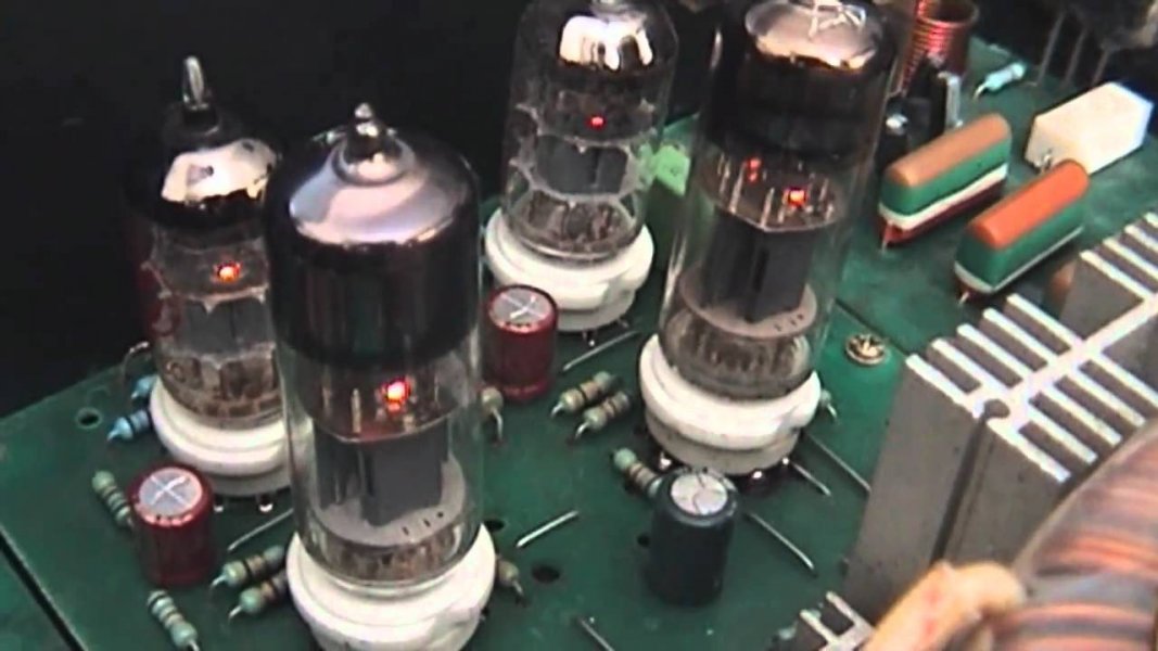

DasguteOhr
Sep 26, 2013
2,441
2,621
645
Germany
The input stage is balanced two OPA, after then it will currios one 6922 tube can unfortunately see how the circuit track of the board looks from below. I think it creates a different distortion behavior. I would have done something different first stage 6922 second stage 6N6 or 6h30 tube. real hybrid amp shouldn't be bashing, sound really good;)
