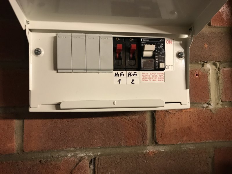

Just a heads-up. There are compatibility issues between a Doepke Switch, a Gigawatt switch and the rest of the components in your consumer unit.
The best solution is a dedicated Consumer unit for the Doepke and Gigawatt, using Henley blocks to T-off 25mm2 tails directly after your meter.
What are the problems?
Firstly, the cable inlets dont align. Doepke inlet is at the front of the switch and Gigawatt at the rear, so you can‘t use a bus bar for the phase feed.
Then, the inputs are at the top of the Doepke and at the bottom of the Gigawatt, so you need a decent piece of 16mm2 cable to connect the 2 (See diagram below)
Finally, the Gigawatt switch isn’t the same depth as regular circuit breakers, so doesn’t completely fill the switch access cutout in the front cover of the consumer unit.
FYI, here’s pictures of the finished supply, the meter tails and a diagram that I handed to my electrician before he got started
Having said all that, the combination of Doepke and Gigawatt significantly outperforms my previously installed dedicated lines based on a regular RCCB and cut-out switch and German-made Klangmodul (Sound module) fuses. The extra work was well worth it.
Thanks for your comments Blackmorec. My photo doesn’t show a dedicated “hi-fi branch” where’s more than enough space, so I think my electrician will be able to install all new devices as you suggested.

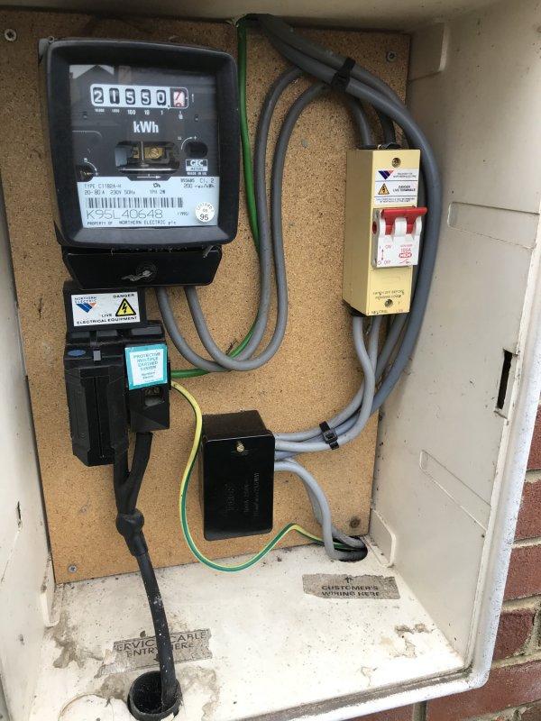

Hello Blackmorec
I think that picture 2 its OK.
Best.View attachment 70941
Hi ,
I come back to this subject which interests me a lot and This photo looks great, but can you tell me if the phase is black cable and neutral in blue please? because in France, the phase is black, brown or red) and the neutral is blue! I just have to installed dedicated circuits from the meter with 2-pole Gigawatt breakers and a Deopker Differential!
Thank you Very much !
Yes, the blue cable is neutral in Spain too.
Please bare in mind that these switches are potentially life saving devices and must be installed correctly. In addition the installation itself deals with lethal voltages and currents and really ought to be done by a qualified person.
Thank you very much !
Yes I am well aware of it ! Thank you very much for caring !
