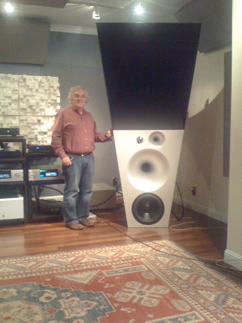

new view of the Ultimate:
To put everything in perspective, the 15" driver at the bottom looks so small!

I happened to find this photo of me back in the days I had long hair and was fat :)
Taken by Alon himself when I visited his factory
