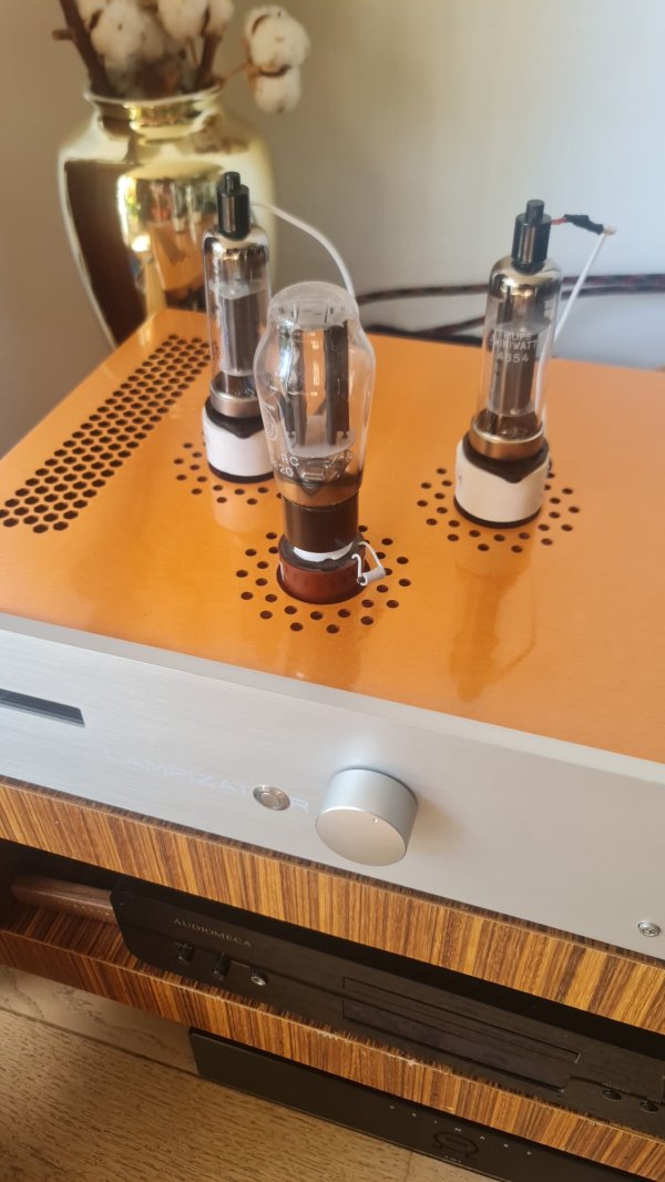

After experimenting with dozens of 6j5 here are two that I find best
Ken-Rad Jan-CKR 6j5GT metal base from late 40s
Teonex(Valvo) big bottle 6j5G

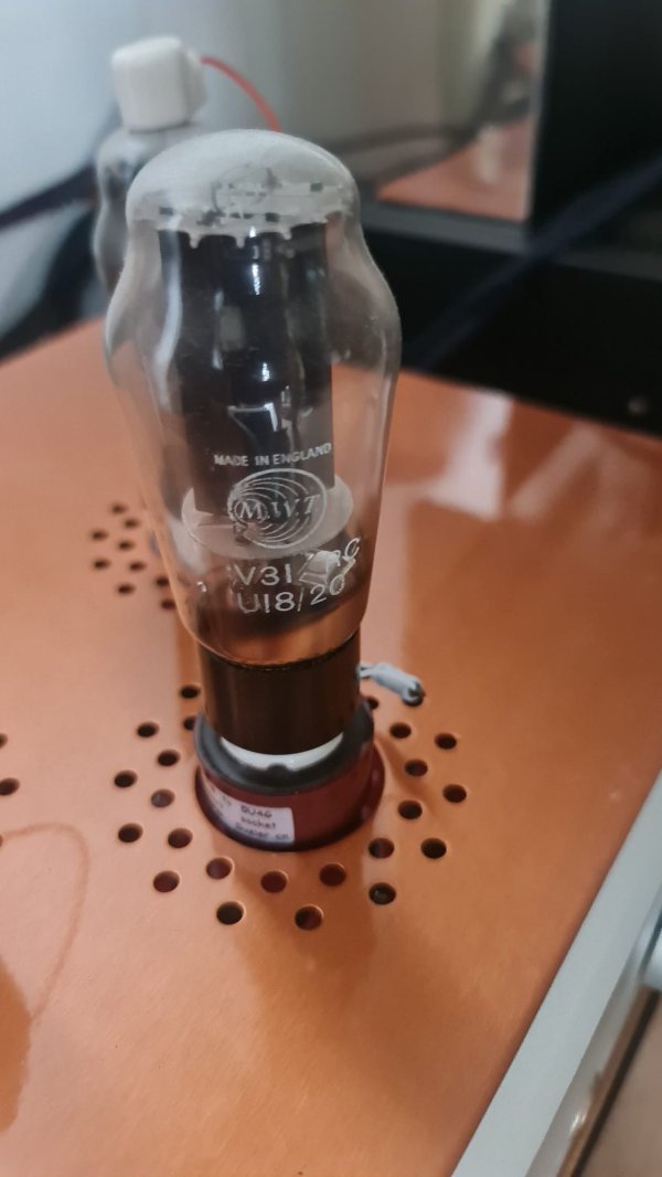

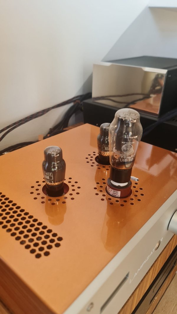

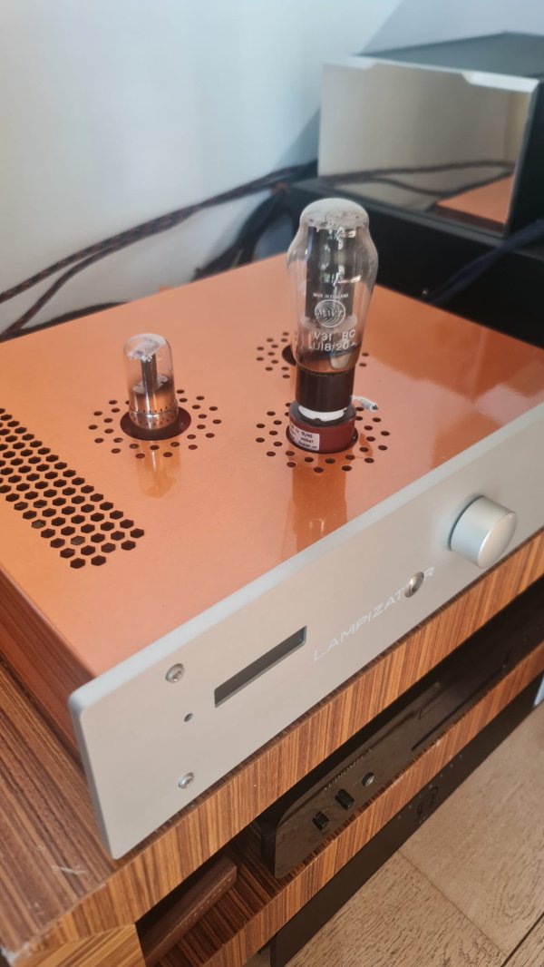

And for me one of the best combination after El12 spez, 4654 Phillips Miniwatt metal base with U18/20
Reactions: Designsfx

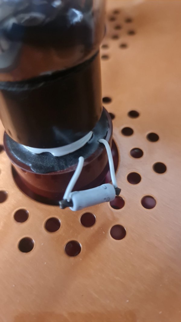

Which adapter have you been using for the U18/20? Isn’t it a 4V tube?

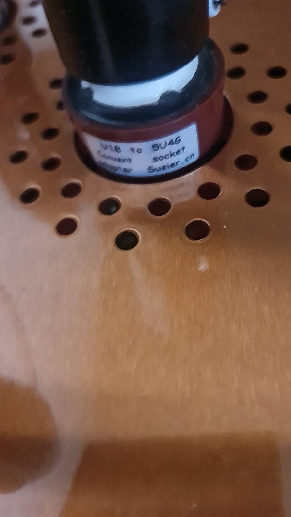

It is 4v tube. I use some U18 to 5u4g adapter. Pictures attached. Think the same adapter can be used for Rgn 1064, az1....
Please don’t do that. According to the following data, U18, U18/20 (which you seem to have), and AZ1 all need resistors of different values.
If(U18)= 3.75 a
If(U18/20) = 2.8 a
If(AZ1) = 1.1 a
If(RGN1064) = 1 a
What this says about the adapter you are using is up to you to decide.

Thank you, I will find adequate adapter

Good catch Ron! I could see the potential for really starving a couple of those tubes if the adapter was configured for U18. It would be nice if there was an adapter that allowed for the resistor to be changed based upon need. Of course then everyone would have to get into resistor rolling as well.

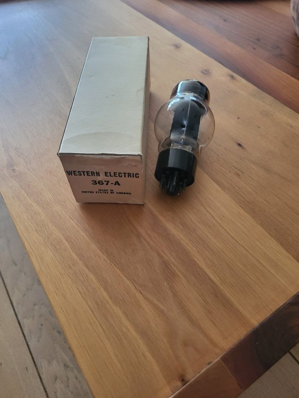

Did anyone tried WE 367a tube. It is supposed to be best tetrode ever? Also I would like to try Cv243 ie 4045a tetrode.
I’ve never looked into those and after a quick search it seems they are pretty rare. It might be interesting but I’m not sure if I’d have adapters made just for that one tube type. Have you tried out the 350b? Definitely expensive but no adapter required.
I don’t believe you can use the 4045a, looking at its data sheet it appears to be a directly heated tetrode. You’re going to need an indirectly heated tube with a cathode.
Reactions: Pollux
350b is almost identical with 367a (same static characteristics), and as you said no need for adapters. I will try it since is much cheaper than 367a, thanks. You are right, cv243 is not for applicable for TRP.
