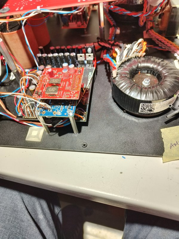

This is a picture of the TRP dac before upgrade to engine 11-p. It has 'standard' the high gain/low gain switch. I did not ask for it. Engine 11-p I did ask. Is was possible because there was room in my Dac. My dac is single ended with no volume control.

This is a picture from Lampizator when they installed Engine 11-p and the upgraded JL boards in my TRP Dac. You also see the huge Duelund Cast capacitors

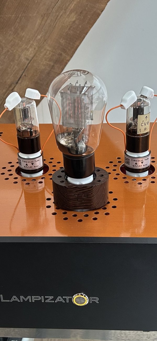

Here is a picture of my TRP dac with GEC CV6 and Telefunken RGN2004 mesh, and t picture of the Three types CV6. From left to right: GEC CV6 Shaw (P), GEC CV6 Hammersmith (Z) and Mullard CV6 (red label)

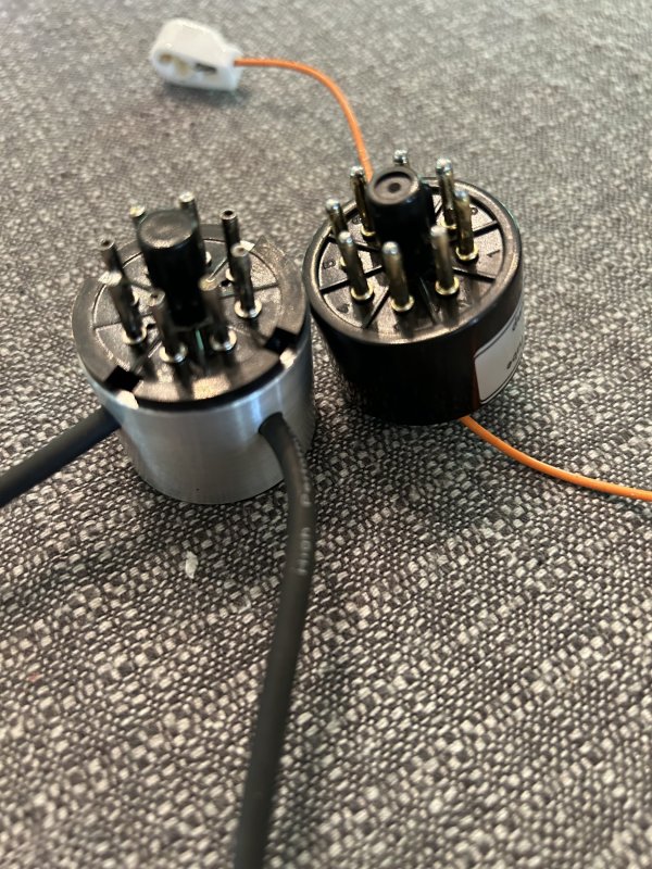

Just to make me feel somewhat safer, I got some adapters that didn't break the bank from a builder on Head-Fi. They seem more substantial in some ways and sound fine - maybe a little better than the chinese ones, but I'm not sure I can say...or hear.
Here are some side by sides with the Xulingmrs.
He uses shielded microphone cable and labels the leads, so that helps. Red to the plate (leads interiorly the the outer post) and blue to the grid (interior inner post). The caps fit better. Point to point wiring, no boards. With the 2->1 6j5->6sn7 adapters they can rotate to align however they fit best onto the gear. Groovy looking brushed aluminum.
30 bucks for the pair delivered. Boom.
I have a replacement for the adapter in question on the way - 35usd.
No Zebrano, but hey now.

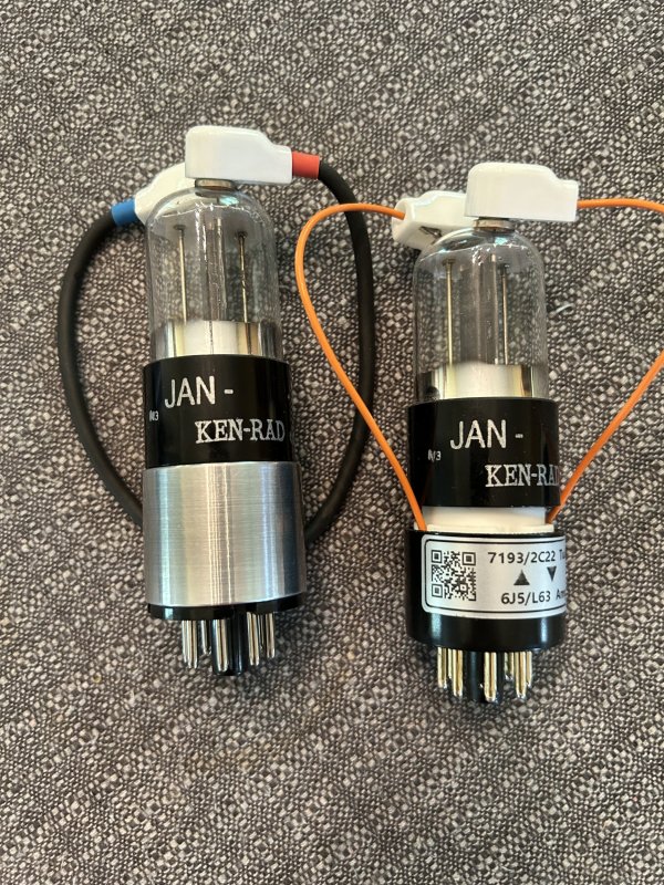

Hey La hey la my Lampi's back....and the tube swapping begins again!
I recently had my integrated modded to accept some interconnects that are very revealing, but smooth at the same time, which had me going back to the old standy RCA 5R4GY to slow things down a bit. It's worked wonders. With other combos of wire, the RCA made things a bit think and slow...mournful almost. BUT with this interconnect I have in place and the KenRad 7193's it provides a roundness while remaining detailed on a very large stage. For now, it's what I'm looking for.
I've gone back and compared the KenRads to the National Union 7193 and Mullard CV6. KenRad is the clear winner there. CV6 a little too warm and less incisive and the NU with a smaller stage and less detaile. I also retried the vaunted Bendix 6384 - still a very nice tube. I could live with either - it's a matter of taste there. I prefer the 7193 for it's slightly less clinical feeling, although overall the 6384 isn't clinical whatsoever and actually has some nice warmth. The KR's have a tiny bit of distortion or overtone that I find attractive. Same big stage, detail, etc.
I think my source, Sound Science Music Vault Ultra modded with SS drives and Pink Faun Ultra AES card/clock, seems to inject a bit of extra energy that I try to balance and tame in various ways. I've tried other sources including Antipodes sources and still liked the Sound Science Cat as much or better - though old, it's really pretty bit perfect and does a wonderful job for me as both server and player.

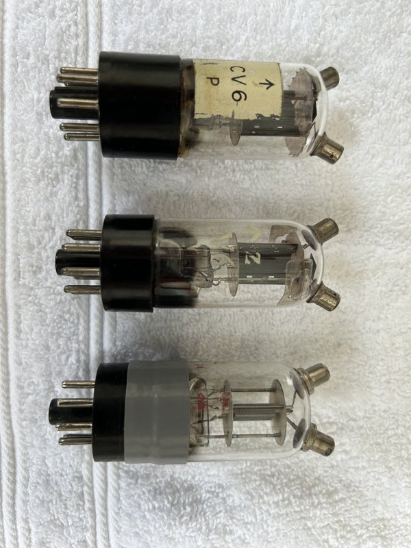

I have tested three CV6 type tubes: The GEC CV6 Z (Hammersmith), The GEC CV6 P (Shaw) and the Mullard CV6. I did all tests with the Telefunken RGN2004 mesh.
The GEC CV6 ‘Z ‘ (Hammersmith) is a very transparent tube. It has an incredible see through quality. What really stands out for me is its naturalness. It is incredibly ‘detailed’ but it is so natural. All music is presented in a very open and coherent space. There is a beautiful flow in the music that is very addictive. They are light on their feet, which means that they are a bit bass light compared to the other CV6 types the GEC CV6 (P) and especially the Mullard CV6. I think that is part of the reason for the open airy sound they produce. But, they can bite… if the music demands it. They are in full control during (very) demanding musical passages. They are fast sounding.
These are more airy, and more open sounding than the F2a. They have depth in the soundstage that the F2a lacks (a bit), more 3 dimensional. With the F2a soundstage is very wide but less deep than CV6.
So where are we then… For orchestral music and opera I prefer (at the moment) the GEC CV6 (Z) with Telefunken RGN2004 mesh over the F2a with RGN 2004 solid plate. Although, I will vary between them. They both bring something to the table. The F2a excitement, the GEC CV6 (Z) airiness, detail and soundstage depth.
For rock music and music with bass, The F2a is definitely better, because it has deeper, more controlled bass, and more drive and excitement. The F2a is the more linear tube, both extended in bass and treble.
The GEC CV6 P (Shaw) and Mullard CV6 are more alike than different. Their tonality is ‘warmer’ , less airy and open sounding than GEC CV6 Z (Hammersmith). Mullard CV6 is a bit warmer than GEC CV6 P, but the difference in sound between GEC CV6 Z and GEC CV6 P is much larger than between GEC CV6 P and Mullard CV6. See my former post on GEC CV6 P (Shaw) on how they sound. They are great tubes, but my main reservation is that when things get busy they tend to sound a bit ‘muddy’ for lack of a better word. Probably because their bass is not fast enough. For ‘normal’ music they are vey natural sounding with good detail, and soundstage depth.

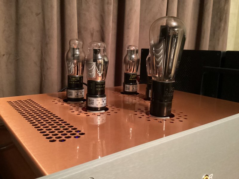

First listening impressions with the “76” Triode
So I’m into my 3rd listening session with a recently acquired quad of NOS Zenith 76 tubes and so far so good! These had an eight hour period with just power on to settle in but so far I’ve had only about 6-7 hours of listening time with them. While they sound better with every listen they still have a ways to go before they’re hitting their stride!
As others have said (and as the cheat sheets state) these are definitely not as high output as other triodes but it’s not that they are really lacking either- a small increase in volume is all that is required to bring them up to the level of the other triodes I love so much.
At first listen I noticed a strange curve between the upper mids and treble frequencies that really drew my attention to the hi-hats and cymbals in the recording I was listening to (Conception of Thought). I noticed the usual ring was not as present and had been replaced with a more forward splashy sound. It was actually interesting to have more focus drawn to these details but I did find that the treble that is normally present seems slightly cut off. Not totally- but enough to be noticeably different. I also found that playing at higher levels seemed to reduce this effect somewhat and of course the effect is really recording dependent.
What I like about the midrange reproduction is that vocals, horns, keys and guitars seem to have a really nice separation within the space of the recording. The midrange presentation is not as forward as say that of the 6F6G- a fairly mid forward pentode, so I find it to be in a comfortable place. It allows for more appreciation of the textures within the music without seeming clinical or overly detailed.
Back to the treble end of the spectrum I find it to be comfortable. Not overly detailed but definitely not cavernous either. Don’t get me wrong- I like cavernous when it fits into the scheme of the things and this quad reproduces this when it’s there but it does so with a little more smoothing as opposed to just putting it out there. Airy reverb decays and delay effects are still perceivable but without the glare that can sometime accompany these effects, definitely a warmer approach to these traits but not what I would call “rounded”.
On the lower end of the spectrum I find the lower mids and bass reproduction to be pretty good. Definitely not as fast as some tubes allow for and definitely not as deep but for the most part in a good place. Again, in this situation some of this can be improved upon with increased output/listening levels.
Overall I like this quad of tubes! The presentation is very present while at the same time allowing for a slight lushness overall that fits really well with a wide variety of music/recordings. I’d like to get my hands on a couple different makes of these as I could see these getting a lot of play! Now I need to hunt down a quad of 37’s to experience more within this vein of tubes.
