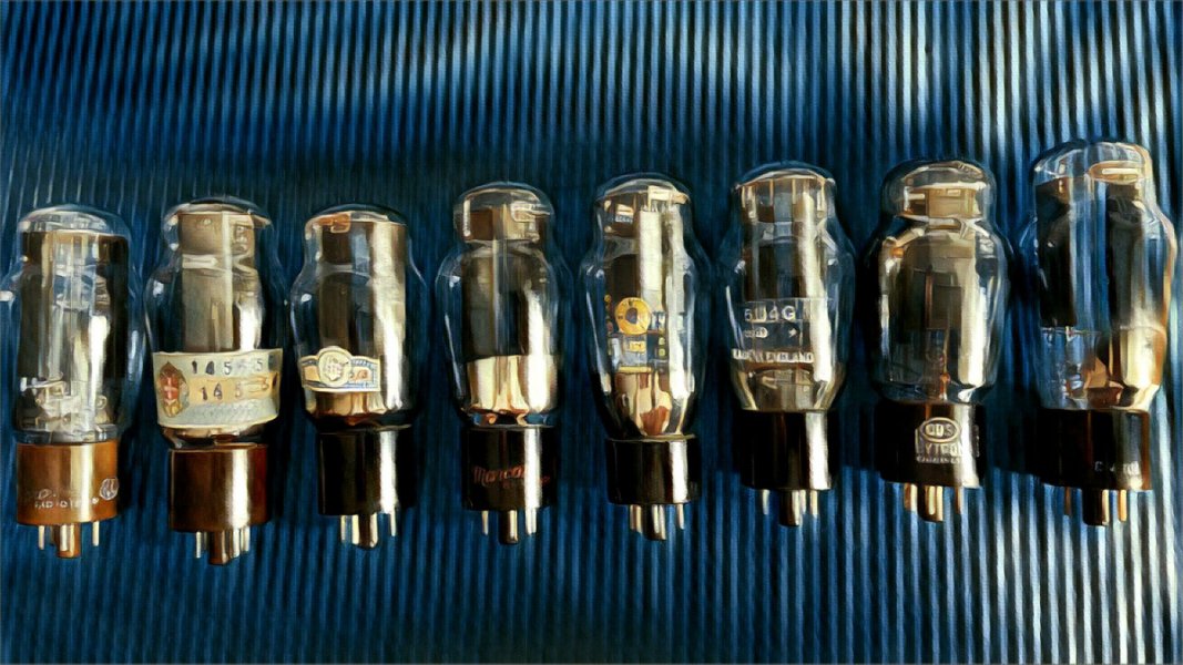

Had an extensive rectifier rolling session with a friend this morning….the overall winner was also the cheapest - BRIMAR CV1863 KB/FE - an excellent allrounder with no notable deficiencies.
2nd place for me (and in the Baltic when the photo was taken) was the EML274b for its airy spaciousness, supposedly a mesh attribute.
Which tube is Heinz & Kaufman? Thanks
These sorts of evaluations are extremely valuable and helpful! For me, I am definitely looking to find an inexpensive rectifier that challenges the high-priced offerings. I'm concerned that the Takatsuki may not have the life expectancy I'm hoping for based on one early failure personally and another by another forum member. If there was an alternative to a $1200 champagne rectifier that can do the job on a beer budget, I'm all for it! Goran loves his inexpensive RCA 5U4G. I love the USA Amperex 5u4G. Both are under $50. Here was have another candidate that might do a fine job for <$50! These are time consuming compares and deeply appreciated!

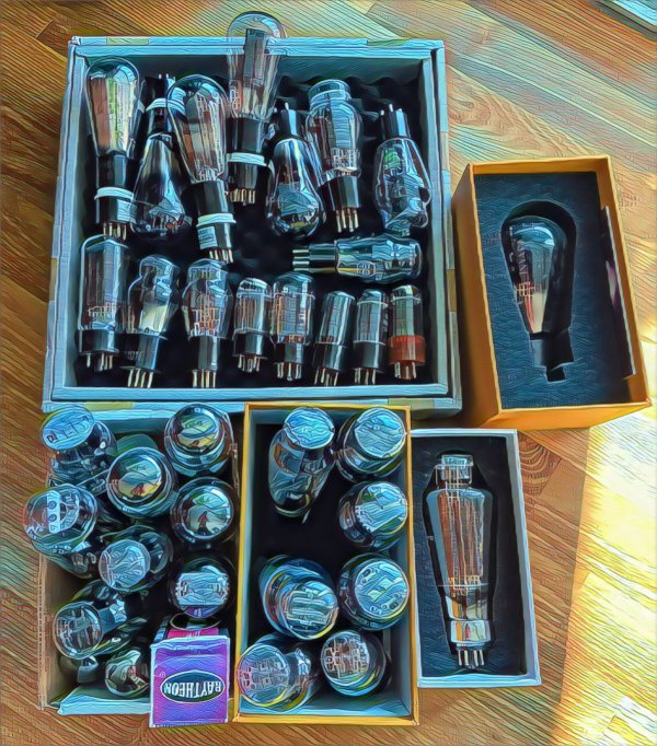

Pity @Phonatix is not too much involved here as he’s the biggest “maniac” i know regarding rectifier tubes and has xyz pcs which he rolled in the TRP. He’s experience is just massive and i can easily say guiding light in terms of recties.
Hold my beer bro!….. Small selection of xyz:
