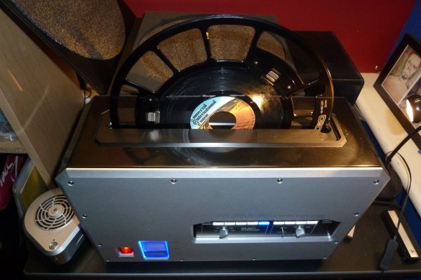

I'm washing until friday with the KLAudio. What a beast ! As I read nearly everything on this item until it comes to the market I go directly to the 5 min washing (asking myself why someone would want to wash as short as 1 or 2 minutes ?).
I find drying for 2 min not allways do the thing especially on thin records.
Have little trouble and ask myself if someone else has the same : on thin records, sometimes the record, during washing time, goes up and down and go laterally from one side to the other... I tried to push it down a bit more but I'm afraid to worn something. It doesn't do this on every thin record.
Someone can help ?
Did not try 1-2 mins of washing time but tried 3 mins, it makes an audible difference compared to uncleaned records, 4-5 mins seemed to me also better than 3 mins cleaning. I also have similar findings for drying. Thin records may need 3 mins instead of usual 2 minutes of drying. Also thin records may sometimes slightly move within holding mechanism. Nothing wrong.
