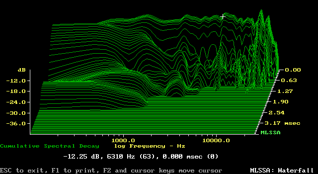

Hi,
the magic of the foil speakers is that they don't have any energy storage effects. I'll link a waterfall diagram, you can see the time in milliseconds on the right.
There you can see how quickly the loudspeaker calms down after a tone. therefore you can hear the following notes of the music more precisely, nothing smeared. that's why I still consider the midrange of an esl 57 to be the best there is.
the problem is, the deeper the tones get, the more the foil has to move it needs more time to calm down, the advantage over normal cone speakers is gone.
to match the bass to the fast slide that it plays coherence, there are 2 possibilities. you switch many small for exsample (8 "cone speakers )in parallel as subwoofer.
This ensures that the cone drivers calm down quickly, that the movements are kept small by being distributed to many.
Second Way create a subwoofer that work like the foil works, a dipole or ripole bass. The advantage is that it does not have any energy storage effects because it does not have a housing that can oscillate.
A good dipole bass can calm down in 5 milliseconds.
This creates a fast, deep bass that goes very well with electrostatics.
I hope I made it clear.
In the last 10 years I have built a lot of speakers myself, some were good, the others ended up being firewood for my fireplace.
Have a nice Sunday

Stephan,
what kind of the software do you use for creating and analyzing the waterfall diagram?

Hi,
Expensive hardware,software and microphones
I don't have my own, I can use one from a friend's, he fixes speakers and reconed speakers.

Hi Stephan,
thank you, I will also try to find a specialist to measure and analyze my room and system acoustics.
As I see MLSSA is a professional tool , I have no knowlegde in this field.
