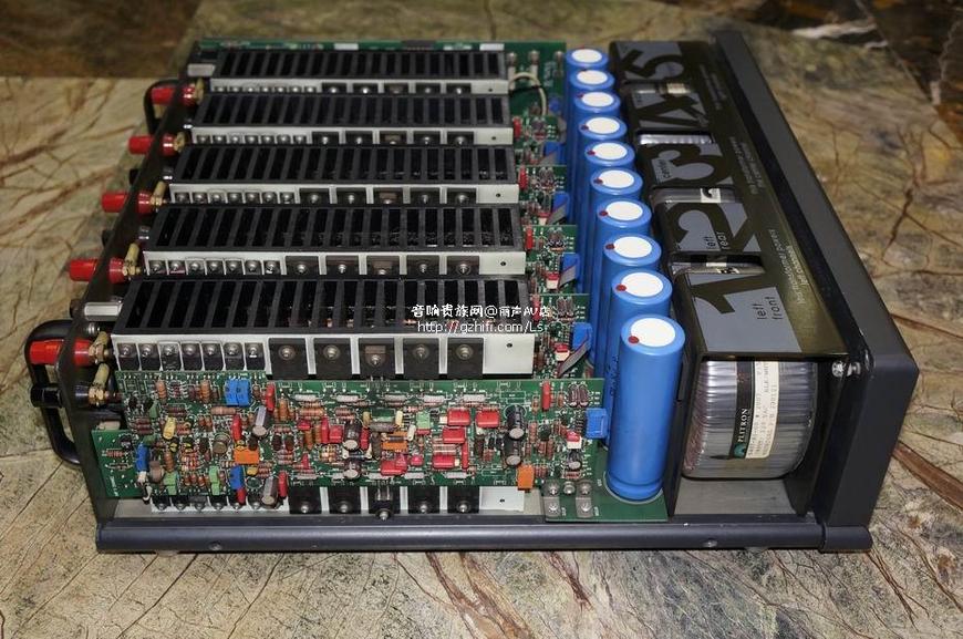

While I have seen far emptier boxes, it hasn't been in the high-end market. And it is not just the transformer that could have been upsized with almost no impact to gross margin. But also the output stage:
Just four transistors mounted on that heatsink? For a 100 watt high-end amplifier? Retailing at $15,000? Surely they could have put in boatload more for better handling of difficult loads. Or just for looks :).
As a way of comparison, here the guts of my Proceed 5 channel amp that is rated at 125 watts/ch and retailed for $6,000 for all of those channels:
Now that is how you pack a box! :eek: :D There are 8 output devices/channel plus a ton of high-power drivers (smaller transistors to the left of them).
Even the big box is not utilized well. That large heatsink is effectively half the size since the heat generating transistors are bunched up in such a small area. The thermal impedance of the fins way away from the transistors is so high that they won't dissipate much heat. So there, they oversized the component (heat sink) since it is visible. But the gets are akin to mass market products.

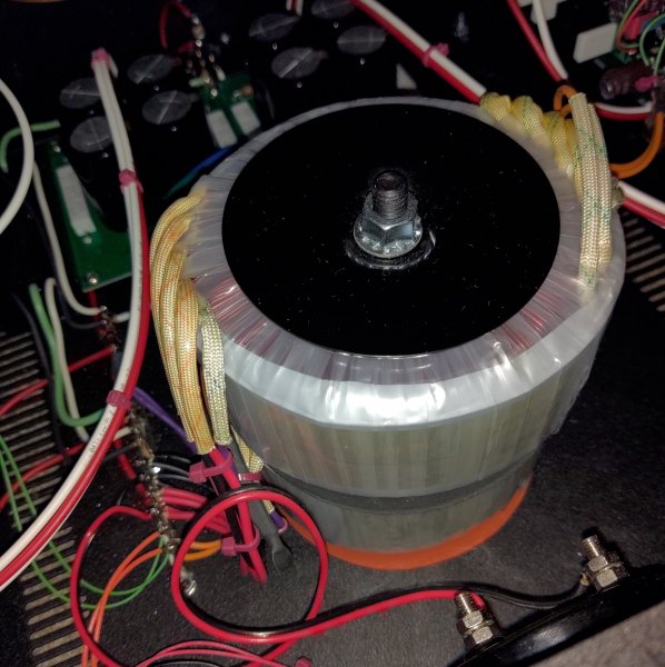

I won't comment on the sound because I haven't heard it. I just wonder how they claim 150/200 w per channel with a transformer that small and a maximum draw of only 350 watts. Remember it's a class AB amp, it's only 50% to 70% efficient. (Unless it is Class D...) :eek:
@Amir, those power amp boards look symmetrical. I agree, there could be a second set of transistors at the bottom of the heatsink.

The question here is putting a very large box around relatively few bits inside. In the high-end, the large box usually goes with lots of goodies inside.

Also, WRT the transformer, it's 2 stacked toroidals, not 1.
