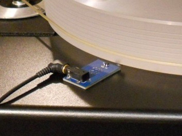

It seems absurd that stylus drag would effect the speed of such a massive platter, but I would love to see a second video from further away showing how that tachometer works and if the lowering and raising of the stylus onto the record effects the speed at all. Christian, is there a laser pointer hitting the platter for that speed check? I don't understand how the 33.333 reading is measured. Is it once every revolution, or more frequent? Do you have a photograph of the entire set up?

It's once every revolution Peter, it's there mostly as a visual guide so you know you've reached desired speed than anything else. Christian's motor case is still a prototype the production units will have the tach display built in.

There is a sensor under the platter edge using a Hall Effect device and a very small rare earth magnet attached to the platter that produces a once per revolution pulse. The tach counts a number of high speed clock pulses that occur between pulses, takes the reciprocal and displays it to 3 decimal places. The time base is a TCXO with 2.5PPM accuracy and 1PPM aging per year.

Thank you. That is very clear and I did not recognize the device that Christian is using. I have read about the Phoenix Engineering products in the press.

Pheonix Engineering, Bill, is the designer of our controller and we're using his tach.

It is anything but meaningless. What it is, would be an extremely accurate measurement of platter speed, produced once per second in an easy to read format, without staring at spots or chasing a blurry line around the room. Accuracy is obviously an important aspect for you, as you wrote this previously:
BTW, just to make it clear, I consider that an accuracy between 33.30 and 33.36 rpm is good enough for me, and rely mostly on a PC audio spectra analyzer to check my equipment, including turntables / tape machines.
So two places right of the decimal is relevant, but 3 places is meaningless? Good news, for those with minor cases of arithmophobia, there is a solder jumper that can be installed that blanks the 3rd digit to the right of the decimal place. For those with more severe cases or those who are accuracy averse, you'll have to resort to masking tape to block out the offending digits.:)
Please read previous posts and what is being debated before jumping in the thread. I am now addressing absolute speed and the subjective effect of speed dragging when the arm is lowered. Not the instrument, but what people do with it.
Anyway what is the difference for a common user knowing he is listening at 33.32 in the morning and at 33.34 rpm next day? IMHO no one will notice it. BTW masking will truncate not round. Surely your system can be used for diagnostics, and it was why I was asking more questions. But interpretation of data is not easy.
My point was simple since start - a good strobe with a quartz strobe flash light is all that is commonly needed to listen to vinyl. I am just thinking that most of our members consider that listening to their tapes is listening to their best source . Are they troubled by how accurate is the speed of their machines? :) I never read a complain of anyone claiming his CD player was playing slow or fast.
