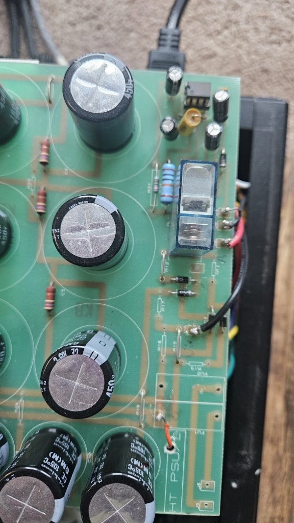

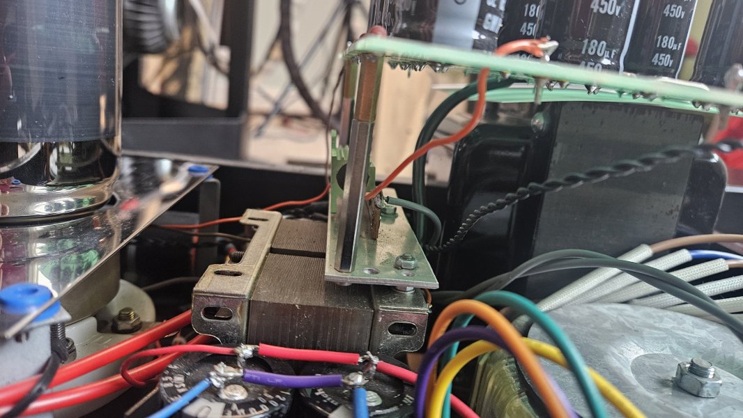

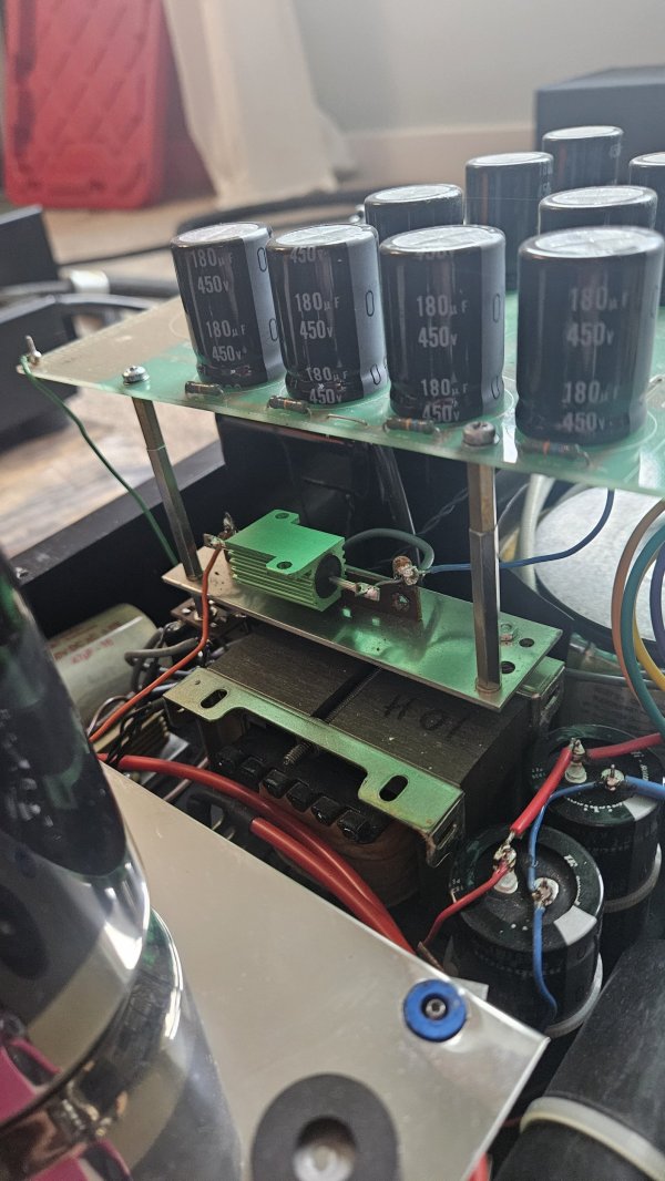

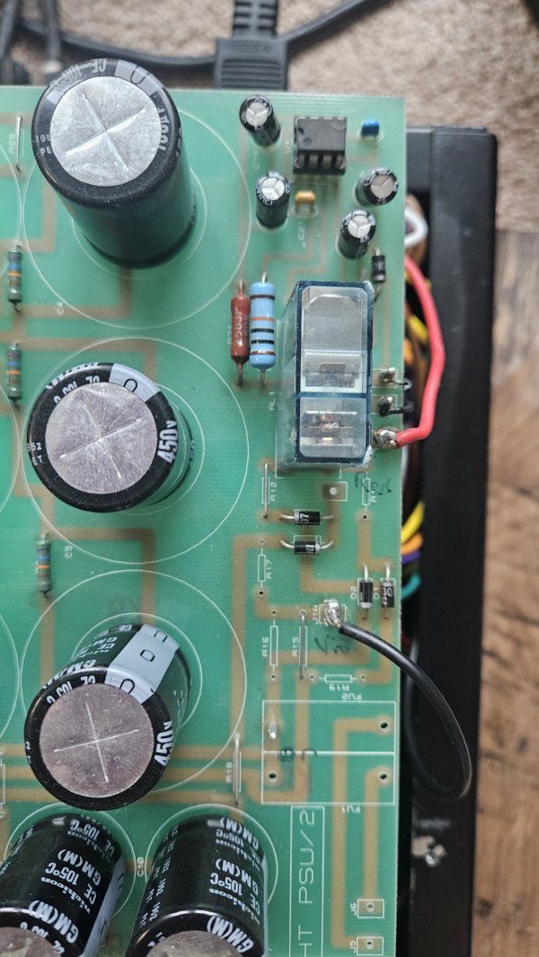

Noisy
Clean
First 2 images are the noisy amp.
The second 2 are rhe quiet amp
There is a small orange wire near the front of the power supply on a post that goes all over. Thats the noisy amp.
On the quiet amp, the same wire goes directly to a cap. .
Both go to this resistor. Way above my paygrade to diognose and solve.

You'll likely have to send both amps along to whomever works on the noisy one. Just looking at the photos there are things that don't make sense including that orange wire- at least one diode that don't appear to be hooked up...
