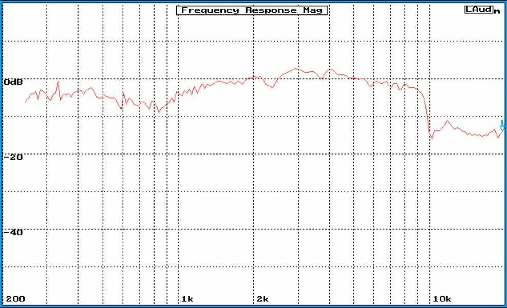

I have tested in openbaffle too, if you separate the RT 64 below 1khz with a 12db filter the thing sounds excellent harmonically above 1khz there is a 5db jump in sensitivity up to 5khz. That is unbearable for me. you can put notch filter in. I had used it from 80 hz to 1khz.
You need a good horn driver from maybe 800hz -20khz
Exsample 285 gm vs 215 rt View attachment 129637
285 View attachment 129638
Mine is the 215-2000 and so is the Cessaro. It wants to be loaded into a horn, which will affect those measurements quite a bit. I got quite flat response from 200 hz to over 10khz….but I cross quite low anyway to a very good compression driver.
