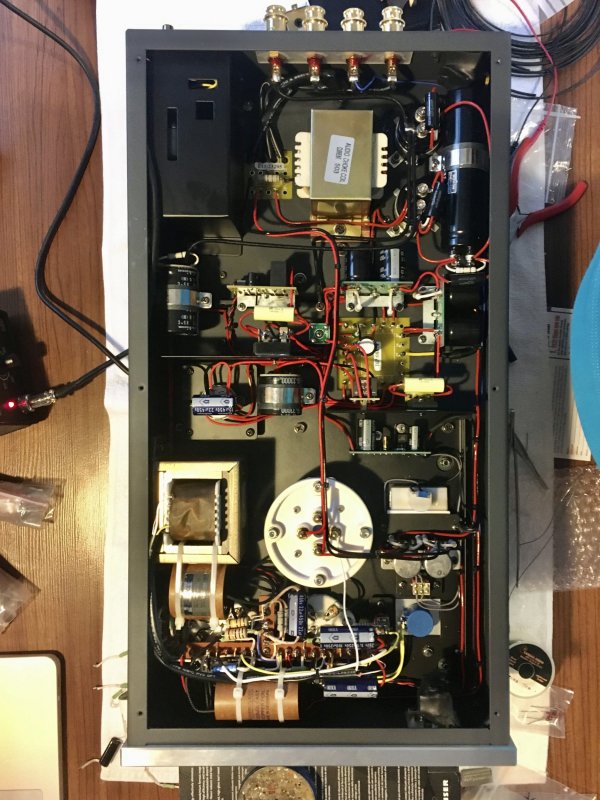

Which coupling caps did you use on your amps?Thanks everyone, very encouraging to hear your good words. Everybody is welcome to a listen to music if ever you come down to sunny Antalya. I do not change my power cables, interconnects, speakers, turntable and arm anymore, I think I have found what I was looking for. I still look into tubes, cartridges with matching phono pres to further my enjoyment but my main area of spending is on vinyl records. Fine tuning the whole system took me further than getting supposedly better equipment. Changing the coupling caps with my amps yielded in a sound so fitting that I did not need to get the wavacs I was eyeing. It would have taken me some more time to get the balance with the wavacs. I instead, went to buy records and listen and enjoy them with that money and more importantly with that time. I do not make big changes. I make small changes, then try and tune everything. After finishing the room and having all the correct acoustic treatments, my pleasure has been doubled to say the leastNow to answer your questions;

They are duelund copper cast. I have also changed the resistors to audio note tantalum.Which coupling caps did you use on your amps?
I love the Duelund CASTs. I've been using the tinned copper version and they have outperformed every other capacitor I've tried, both in low voltage speaker applications and high voltage coupling caps in amplifiers and DACs. A wonderful product.They are duelund copper cast. I have also changed the resistors to audio note tantalum.

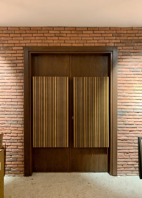

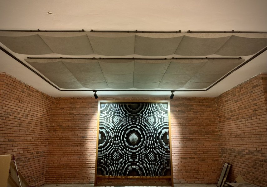

What size is your new listening room Kodomo ?I am now moving to a new house. I started working on my new listening room, here is a preview. The ones on the ceiling are 24 of artnovion andrea absorbers. The front wall diffuser is 2m by 2m and it is quite a feat. It is effective from about 450hz to 6880hz. The ones on the door behind my back are artnovion siena wall bass traps.
I will add 18 diffusors on ceiling next. Then the absorbers with diffuser fronts to right and left first and second reflection points. All four corners of the room will also have corner bass traps. There are some more but I will share photos and update as I continue building it.
Roughly 6meters by 8meters for the listening room, there is an adjacent studio and an entree. My prior room was larger but it was also the living room of the house.What size is your new listening room Kodomo ?
