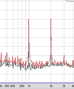

I have Balanced Cable between my DAC and preamp.
I generate two tones, 1000Hz and 2000Hz at equal amplitude.
2000Hz is the second harmonic of 1000Hz.
If the "second harmonics" of the signal are being lost or attenuated in a balanced cable, why don't I see some drop in the output level of the 2000Hz tone?
I happily defer to the electrical engineers here to answer that question.
