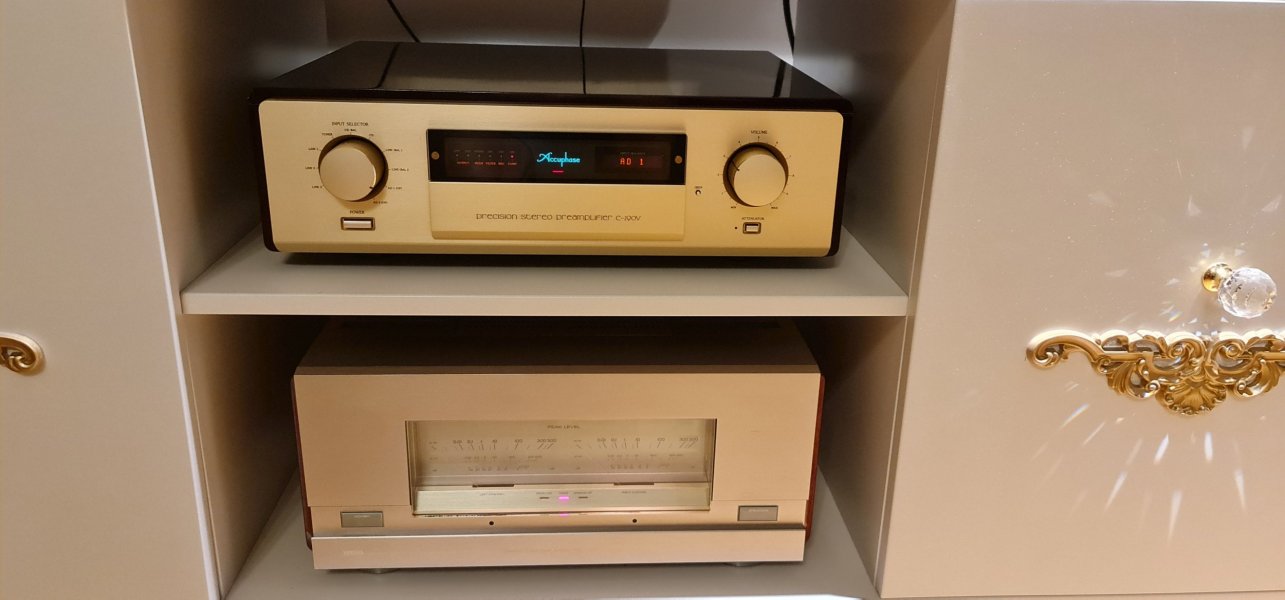

If you world have the below system... What Cartridge world you fit in? (I have to admit i am fond to Koetsu):
- TT: Pioneer Exclusive P3a (i have all arms, straight & S shaped)
- pre: Accuphase C-290V (incl phono module)
- amp: Yamaha MX-10000
- speakers: Yamaha NS-2000
Thx in advance!

Nice system! What is the highest effective mass the various arm wands offer?

My Ortofon A90 always sounded great with my P3 - straight arm of course.
Currently using a Lyra Etna which is also great.
Old skool AT25 and Technics EPC1000mk4 the P3 also sounds stunning
The tonearm is EA-03 with interchangeable wands S-type or straight type, but was not able to find the effective mass anywhere yet. I have started the process of translating the manual from Japanese but based on my readings in different places it is not specified ... still I will complete the translation and come back if anything relevant
