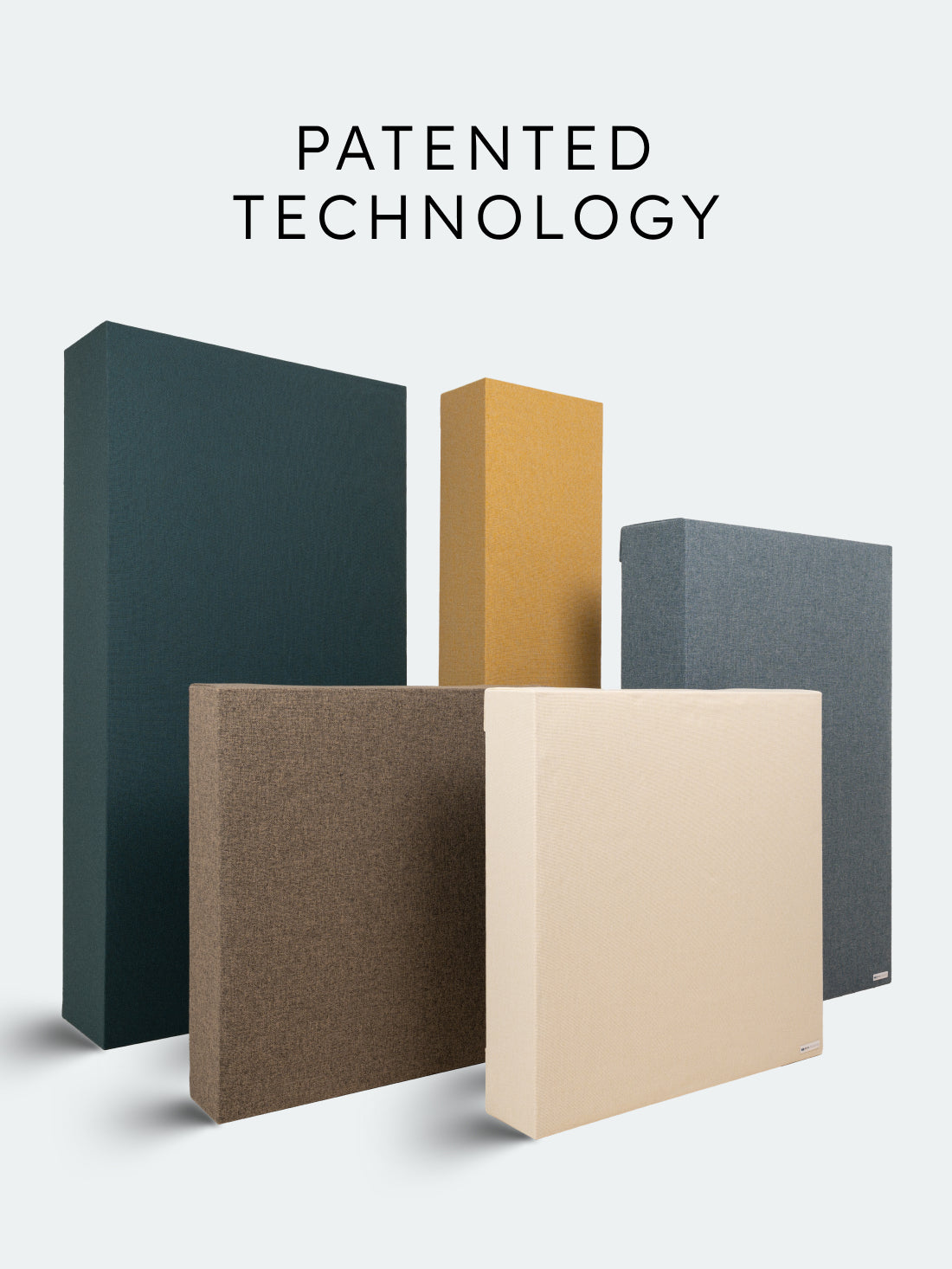

Hugh, you described the GIK panels you used as “diffuser/ absorption panels“, but for clarity, were the GIK panels your tried fronted with their optional membrane or wooden diffusor plates and, if so, which design were they (range limiter, scatter plate, or ?)?

These

RPG, which invented and patented the "binary amplitude diffusor" has both flat and curved BAD panels which work very well (I use them):
The perforated GIK panels shown above appear to be a copy of the RPG BAD but I don't know if they have the same computer generated perforation pattern. The GIK panels with wood grilles would mix reflection and absorption, lessening the potential for deadening the room, but not sure they provide any actual diffusion.

...the GIK panels noted are made from computer generated modeling. There are 1D and 2D versions. I use the 2D versions and they work well.
Actually, the GIK site has some interesting videos and room calc tools, if interested, as well as test certs for products. You can also contact them for free consultation:
I believe they have US and UK locations.

The perforations appear smaller, more numerous, and in a different pattern on the patented RPG BAD panels than on the "knockoff" GIK.

...that would represent the percentage of reflection vs. absorption. Perhaps GIK engineers favor a different set of values for their product engineering. The test certs are interesting. BTW: I have no dog in this hunt. She's on the recliner, actually.
