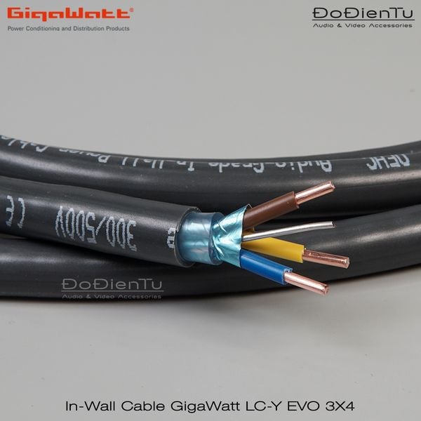

I'm from Hanoi Vietnam, and I'm running a dedicated audio line for my system. The cable used is GigaWatt LC-Y EVO 3X4.
At first we plan to run the cable from our inhouse electronic panel on first floor, with a seperate audio CB there into the listening room on third floor. From the inhouse panel to our electric meter outside the house there's another 15m of cable that was provide by the national electricity company. Now after reading your advice on a acceptable dedicated line, an uninterupted cable running all the way to the meter with 1 CB right after meter with good separated grounding is the way to go.
The problem is I have 36m in wall already (cannot be changed), with a CB for the dedicated line on first floor panel.
Now should I buy the remaining 15m and mannually connect the 2 cables, move the first floor CB to right after the meter ouside our house. Is this the optimal choice? (given we don't have the budget to buy the whole 50m of Gigawatt cable again to run it from meter to audio room like you guys advised).
My main cocern would be the manually connecting 15m and 36m cable part, will this degrade the cable quality greatly?
Are there any better choice now, using 2 CB, 1 right after meter and 1 on the inhouse panel, to avoid the manually cable connecting part? (Actually our electrician advised on going for the manually connecting and 1 CB route).

Hello Novacdjokotoet
1. If that 15 mt. cable from meter to panel on first floor is a separate line for audio then it’s better to replace it with the same cable that you use from panel to third floor -In this case GigaWatt LC-Y EVO 3X4-. Then getting rid of the second CB on the first floor and connecting two cables with appropriate connector or soldering is the best option IMHO. This way you can have a cable with one interruption and one CB.
2. If that 15 mt. cable from meter to panel is a common line both for audio and anything else in the house then use it as it is. Alternatively you can replace CB with Gigawatt’s.
https://www.gigawatt.eu/produkt/g-16a-power-grid-overcurrent-protection-switch/
More importantly please check your country’s electrical code before doing any of the above mentioned alterations.
Regards...

Very good advice on checking the country's electrical code first, before doing any alterations. However, Novacdj is based in Hanoi, so very similar to my former home town, Colombo, there's no electrical code, anything goes! There must be a code but I don't think anyone adheres to it. In Colombo the main electrical code in doing such alterations is first, try not to get electrocuted! And when you do get electrocuted, just make sure you're wearing rubber/ insulated gloves, that's pretty much the code!
Cheers, RJ
...I would recommend NOT soldering these joints. You will have something like the pictured fixture in VN to make a good mechanical connection, if not affixing into panels and breakers. Be safe!
