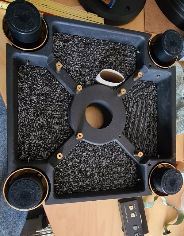

like I told Bill reg the filling of the arm tower.......
I just loaded the plinth of a Micro Seiki DDX-1500 with 8kg of leadshots potted in Raytech Magic Rubber, more than doubling the plinth weight, and it´s absolutely inert and dead......this floating 2 component rubber is a potting compund to control vibrations in electronics...highly recommended
once mixed you have 10 mins.....

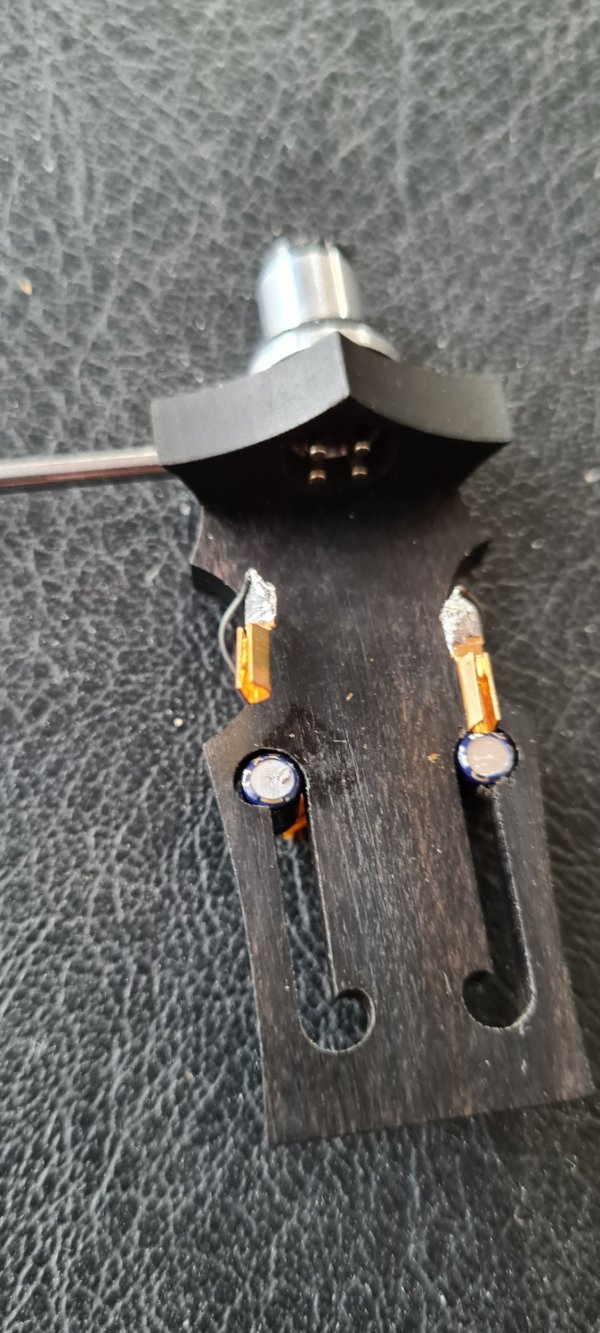

Update 2x. Shielded wand cable + Black Gate Super E paralleled.
Initially I was hoping to do the shielded cable trick separate to the capacitor mod. (Unfortunately) I had to do them together for pragmatic reasons. So please take my commentary as a package. Please also note I only managed to use shielded cable on the wand itself because it is too thick to allow enough flex for tracking. I will install shielded from dc power supply to stage 1 filter next and join the screen to this one with a silver wire.
Anyway for those who want to jump to the conclusion. You must do this if you own a DaVa. You can expect a noticeable increase in ambience, decay, nuance, and staging space. No change to the musicality or tone. It isn’t subtle at all - very obviously improved!
For those more interested in how this manifests in music, I will write again on the matter after I clock more mileage. Meanwhile, see photos of the rhinoceros:

You shielded the arm wand too? How many grams the shield put on the weight?
Audiophile Bill
Mar 23, 2015
4,293
4,093
675
Hi Tang. I have used a shielded wire - uses 2 x 26GA silver conductors with a shield and 2mm outer jacket. I haven’t weighed the cable but would estimate it is a few grams more - certainly needed to redo VTF again.
Hi Bill,
Quite impressive looking and I am sure more than impressive sounding!
Let me see if I have this right: you ran the 2 x 26GA + shielded wire to the Black Gates and then soldered or attached the shield to the wand? Then you soldered the original dc wire running from the two fc clips to the Black Gates?
Not sure what you mean by “join the screen to this one with a silver wire"?
And how will you run “shielded from dc power supply to stage 1 filter,” assuming that your stage 1 filter is the Audio Note Kaisei?
Also what are the values for the Black Gate Super E set?
Sorry for all the questions! I have my tube PSU coming from Darius at the end of the month and plan on implementing what you have done here....as long as I know what I am doing!

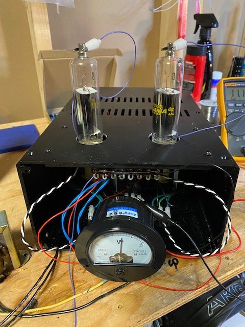

In development:
My DaVa cartridge is backed up to September, however I immediately started on a damper diode EY-500a power supply.
Still some tweaking to do and as we say in research- incurred development costs with the iron as there is sometimes no way to tell until you actually piece it together. I modeled it in PSU designer -its so close but I have ordered some other pieces to dial it right in.
More to come eventually.

Hi Bill,
> Thanks - yes indeed jt
> As of now, the shield is fully floating. It will be attached in the nexr
> There are 2 very small wires from the black gates to the cart itself (a few cm)
> The shielded cable can only run the length of the arm wand because it is too inflexible to allow good bearing operation. Therefore there is a section of silver cable from the end of the wand to my first filter tower.
> The power supply itself feeds the first filter tower.
> Will post piccie later.
So I want to ground the screen of wand length above all as it is floating right now. But since I have to “break” the shield for the small flexible wiring to filter 1, I need a solution that takes the shield ground from that section of cable to the section that comes immediately from the power supply. I could just tie it to the negative but didn’t want tk
> I will reterminate the power supply wirh
> They are 0.1uf - there are 2 in parallel short leg to long leg as recommended
> Other caps might be great just you’ll need to find uktralow mass
Enjoy!
oeno
Jun 7, 2014
43
61
323
Enjoy!
Thanks, Bill, for the replies! I think I can manage the Black Gates or other tiny super low mass caps on my headshell without balance or excessive weight issues. I don't have any hum issues at current. Given the aural benefits you are hearing with the shield floating, I think I may skip a new wire and simply solder the Black Gates into the existing fc wire that terminates into the cart. As I have to do it in situ, it will be a nervous bit of soldering.
Reactions: Audiophile Bill
Audiophile Bill
Mar 23, 2015
4,293
4,093
675
Yes that makes sense. I had no hum issues either :)
This removes another layer of haze you weren’t aware was there until it’s gone.
I have learnt this weekend that the Black Gates are a of to burn in! I thought it was a myth but sure enough day 1 was astonishing, beginning of day 2 my bass seemed to go, then treble got a bit raw, and last night things were returning. Leif did warn me to try to pre burn them in but I was too eager. I would personally try to burn them in before using if you can.

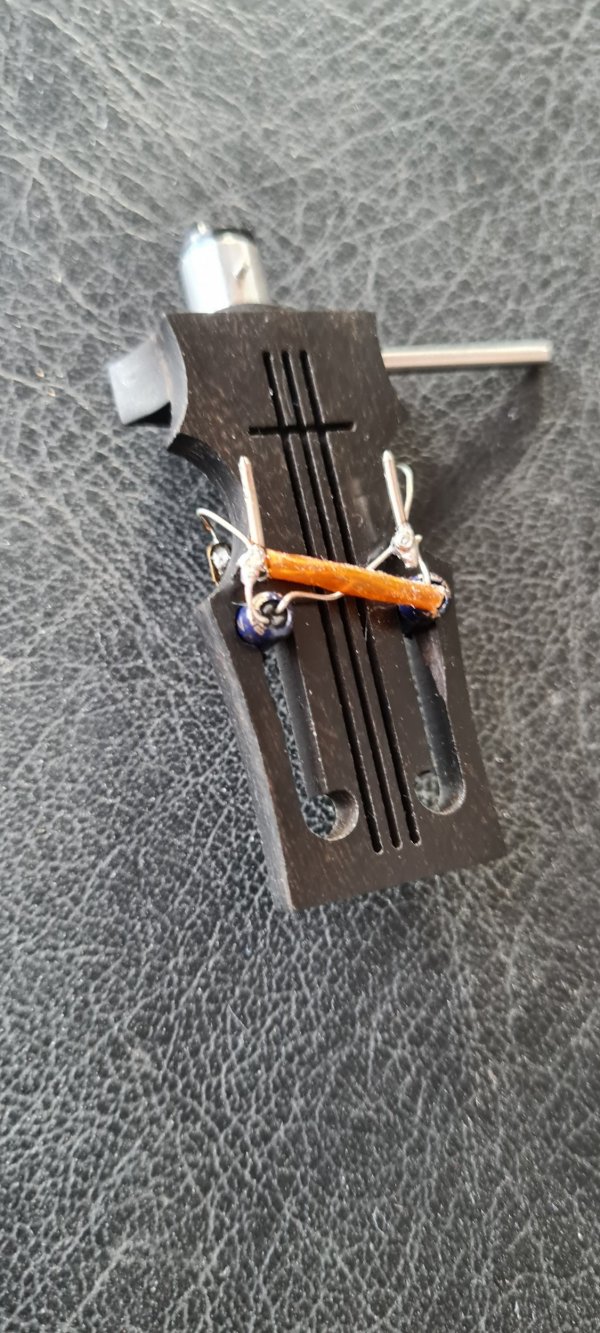

here´s my way of solving it
like the idea of being able to disconnect headshell including dc without messing on the cart pins
