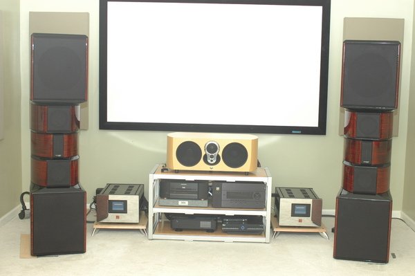

I personally find speakers moved very far into the room far more offensive to my asthetix sensibilities (especially large ones) than some panels on the wall / ceiling. I have not done any measurements yet, but unless moving the Evolutions Acoustics MM3 to far back into the corner completely destroys the LFE response curve, I am going to compromise a little on optimal placement for this reason.
This what my room looks like now - corner bass traps will be constructed this week end. Panels on ceiling probalby later.

Looking good!!
The mother of all multi purpose rooms. Audio / video, 2 channel and multi channel! Not without compromise, but good enough for me.
Sounding pretty good too right out of the box. This week-end will be setup optimization. Really curious to see how much the Trinnov DRC does. In the absence of a custom designed room. I probably need some digital help taming the bass response.
