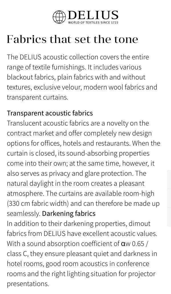

The transparent option seems interesting (I didn’t get blackout drapes, but they don’t let in light).The company’s website, however, does not indicate any interest in the home market or exporting outside of Germany, let alone across the Atlantic. Of course, Trump’s tariffs might make the latter prohibitive.
