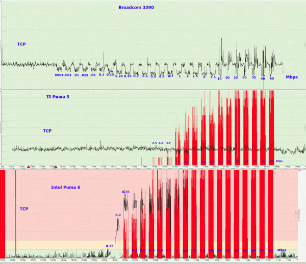

So.. Modems.. It turns out I am kinda a expert on cable modems. There are only 2. EVERY modem in the market is based on either Broadcom or Intel. Each company produces a hardware reference that is then used by all the CPE makers like Arris, Netgear, etc.. You crack these open and these devices are remarkably the same. YES how they implement power supply differs in LAYOUT and SOME config, but, mostly its the same across all mfgrs of a modem chip. So crack open a Arris SB8200 and a Netgear CM1000 and you will find exactly the same parts, with the same part numbers, located in about the same places. So GENERALLY these devices are nearly carbon copies but with different packaging and sometimes more ports. What REALLY counts tho is what chip. Intel based modems are HORRENDOUS in jitter. Class action lawsuits, news reports. This site has details and what CPE models are based on this Intel chip. http://badmodems.com/
So.. Intel based devices should NEVER be used. This means Broadcom devices are where its at. DOCSIS 3.1 modems have OFDM modulation and a cable co usually combines a 32 QAM modulated channels with a OFDM stream. This combo produces a much cleaner ( less jitter, less retransmissions ) then DOCSIS 3.0 modems from a few years back.. Also these DOCSIS 3.1 modems can be set up with Link Aggregation to a good router. This *might* be good as other house traffic might find a way thru the device without disturbing the audio flow as much.
