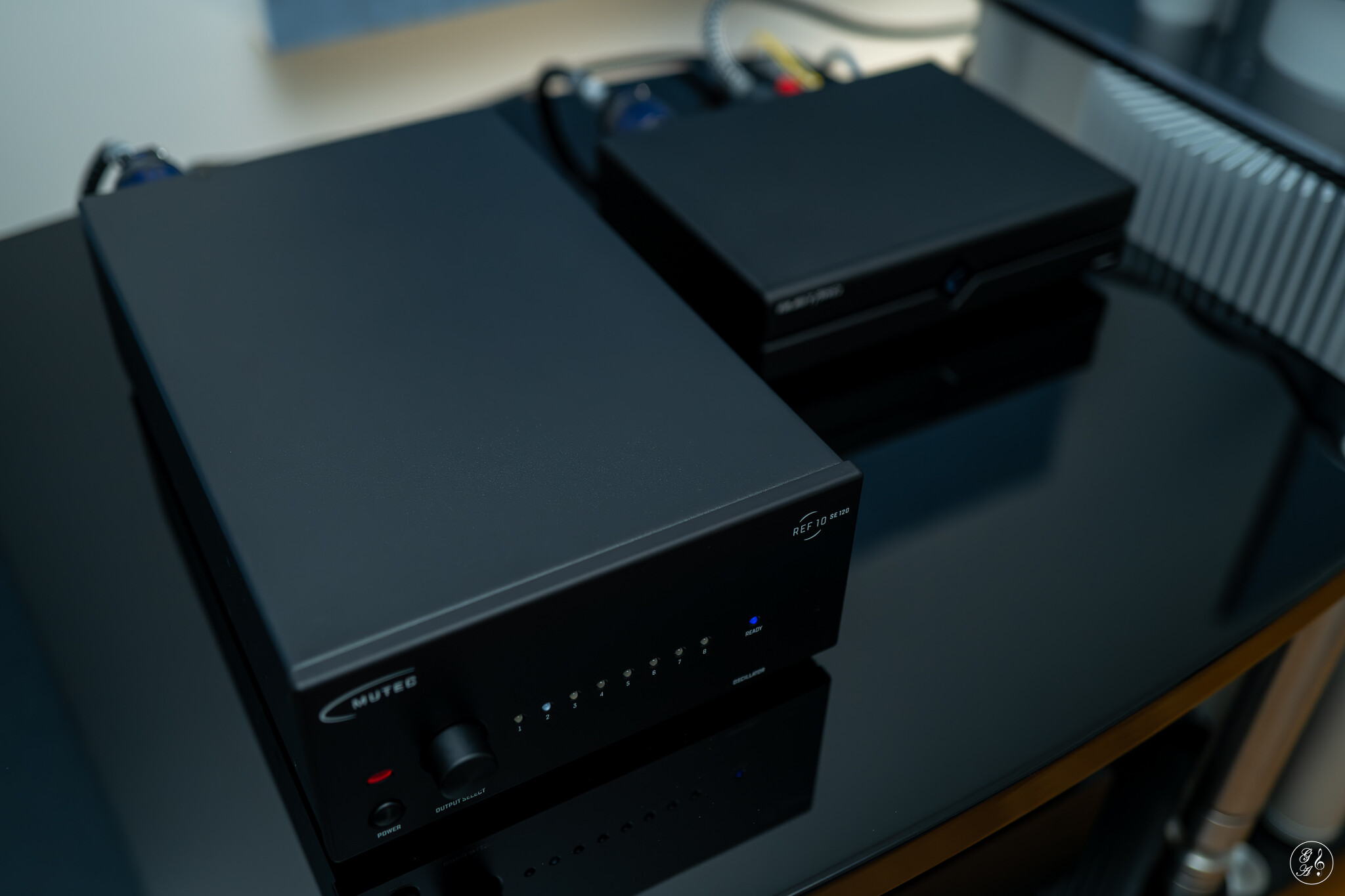

Q1: Is your Mutec attached to your DAC or your switch?
The Mutec Ref10 SE120 is connected to the switch. I use a GUSTARD N18 PRO.

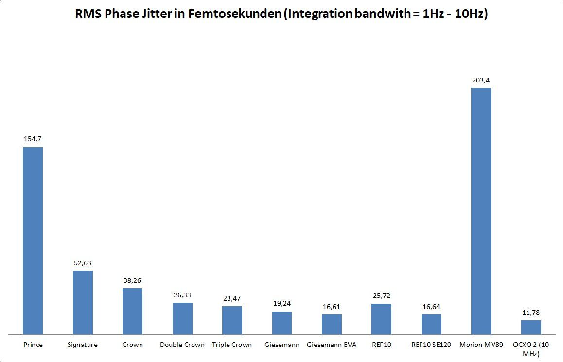

Swenson calls phase noise which is distortion in the timing domain
While jitter indicates deviations in the time domain, phase noise uses the frequency domain. The same drift can be derived from both values.
When phase noise converted into jitter, the comparison (the lower, the better) shows that the clock generators from Mutec (REF10) and Afterdark (Giesemann) are of excellent quality, depending on the characteristics:
Source: https://www.aktives-hoeren.de/viewtopic.php?p=240701#p240701

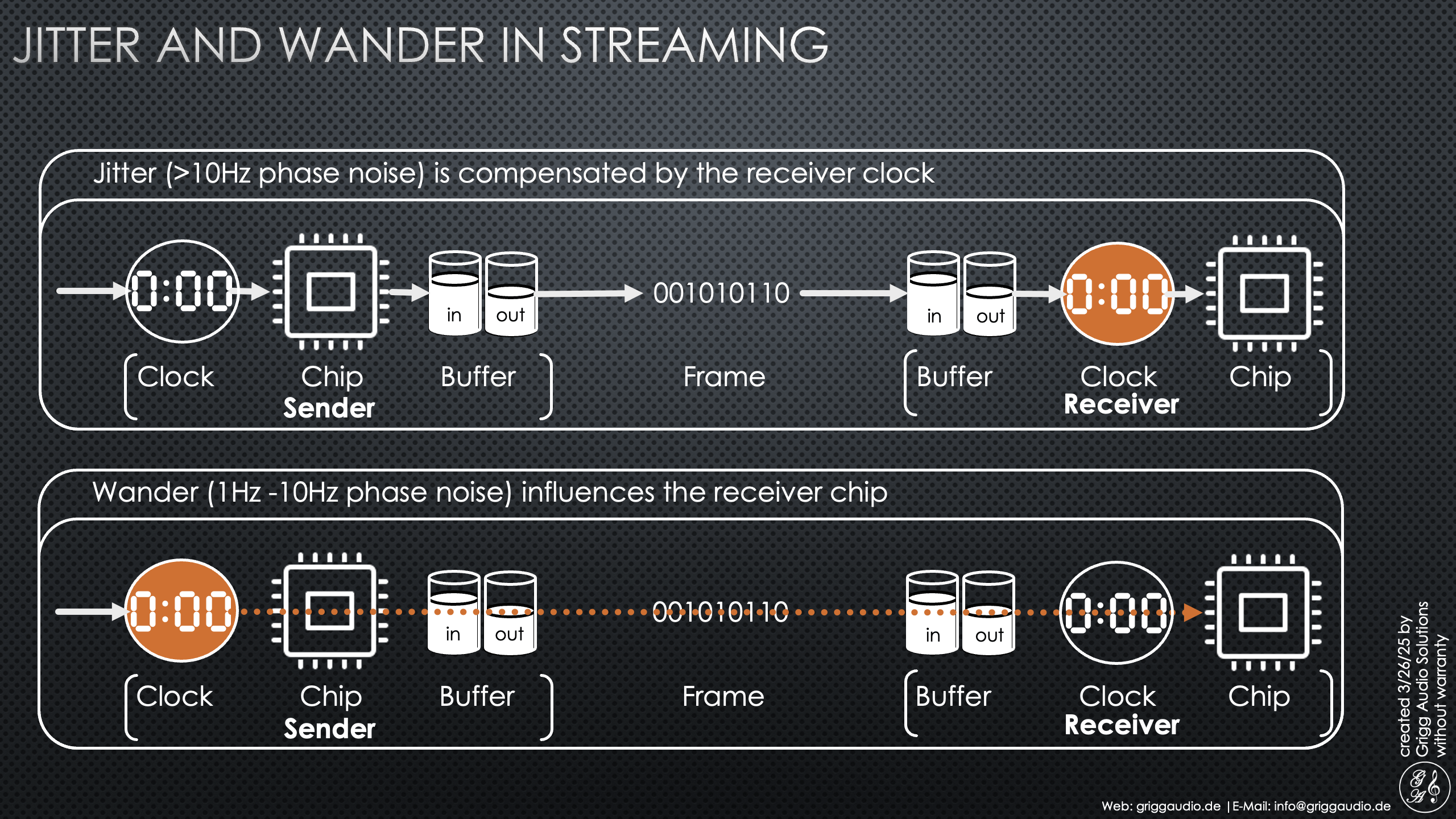

I understand what phase noise is, and post-streamer I'm with you.
On jitter, we have the pre- vs post-streamer domains to consider. Jitter in ethernet is a term used by network engineers, typically running heavily loaded corporate networks, to describe any variability in the timing of the arrival of data packets/frames at the receiving network node. This is the same word but with an entirely different meaning to in the post-streamer (bitstream) domain.
Let's no forget that (a) under ethernet protocols, errors are checked at the receiving end and if a packet needs to be re-sent then it will be, (b) the streamer will buffer the packets before (c) extracting the digital data from them and constructing a continuous (and timed!) bitstream which the DAC can recognise. This is why clock accuracy is not relevant, though clock quietness may well be (or some other mechanism we are not yet aware of).
This is why I think we can dispense with timing as a concern. It's just the way this stuff works which makes it a non-concern.
Phase noise on the other hand? This is why I'd like to see an explanation of how this gets coded into the data. And how it impacts or survives through the massive data transformation inside the streamer.

Thank you for your thoughts. I found a recently published series of tests by alpha-audio interesting.
Can noise ride along over a fiber connection? Yes… it certainly can. We see broadband noise as well as the 1 MHz sine wave pop up on the scope. Is it attenuated? Yes… of course, but it’s not gone, as many will expect with optical decoupling. After all: electrical noise cannot drift along over a fiber link.
In my opinion, it implicitly confirms John Swenson's theory that Wander also travels via fibre optics.
But I think we are moving into an area that few people understand. I am one of those who do not understand it. For me, it is like quantum physics. Everyone knows it exists, but only a few understand it.
Therefore, my recommendation is to simply try reclocking. Scientific progress is not based on an explanatory model, but rather on researchers simply trying something new. The explanatory model is developed afterwards.
