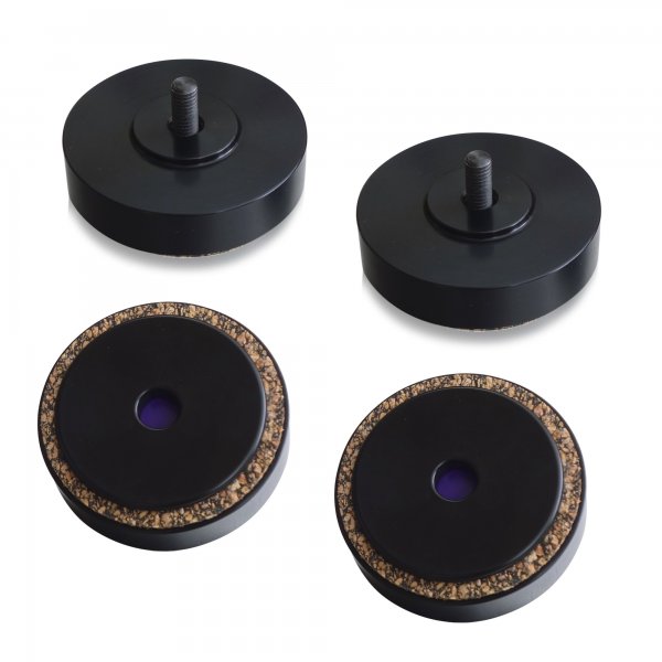

Thanks for the suggestions. I’ll investigate the EVP Pads – not heard of them before. At only 1” in height they may be good, although they look pretty awful!
I bought some footers that look OK and are also only 1” high – Bfly Audio Talis Pro L in black. https://www.bflyaudio.uk/store/p19/LINNTALISPRO.html
Made in Germany and seem to be well regarded under speakers. The L version is good for up to 400 Kg per set.
They screw straight into AG’s adjustable spike assemblies (once the spikes themselves are removed) using the 8mm threads although other threads are also supplied. The advantage over many other footers is that it’s easy to move the speakers over a solid floor. AGs fitted with Gaias are almost impossible to move!
I’m content with these Talis footers for the time being but may look for something else once I’m happy with the looks and positioning of the speakers. I’m still waiting to hear from the local steel fabricator who made the F frames for my earlier Duos, but I know they are busy at present. It’s such a piddly little job I don’t really want to hassle them.
I took a look at the XD software and played around to see how it changed the sound. I was impressed at how much it could do, but only if your ears are good enough to know exactly what to change. It even offers numerous crossover types between the bass and mid – Butterworth, Bessel, etc. These offer varying slopes and make quite a difference in the sound. I think this XD software with the right guidance from microphone measurements and an experienced ear will offer much better results than most room equalisation systems as it doesn’t add any circuit into the equasion. I’ve used RoomPerfect, Dirac Live, Anthem and MARS with various systems I’ve bought or had on load over the last couple of years and concluded that, although they may iron out the peaks and nulls, they also take away a little of the life and excitement from the music. In the end, I turn off the filter and enjoy the imperfections. If the XD does what I hope it’s capable of, I should have a flat response without flat-sounding music. I live in hope! Peter
