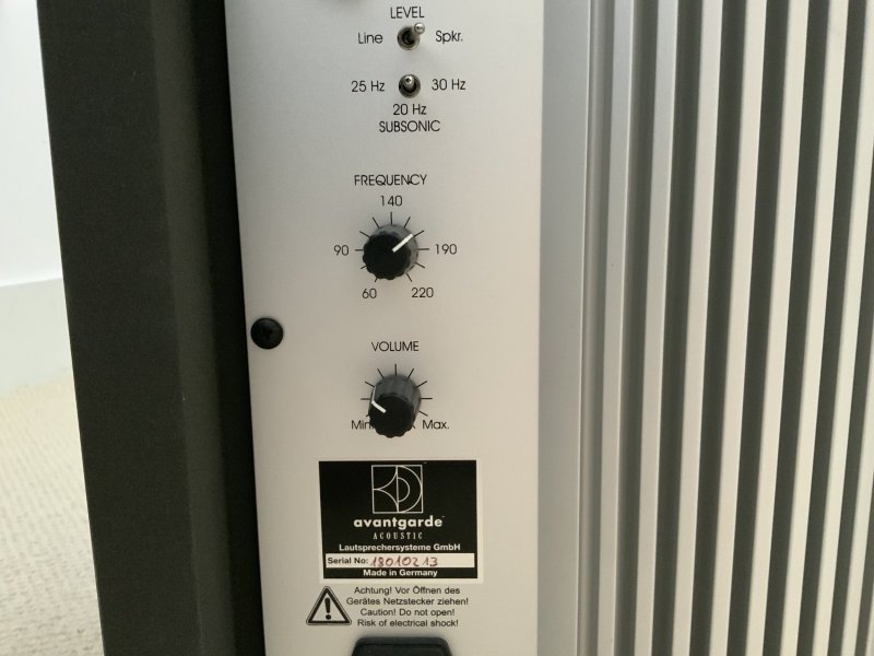

That's true according to the AG spec although I've found (and many others too) that setting the XO at around 140 Hz offers a better, less muddied sound around the crossover between mid and bass. I believe (although if he's here I hope he will correct me) that Jim Smith favours a lower XO than the brochure suggests.
I'd be interested in your experience if you have Duos. Try a lower XO setting if you haven't already done so. Peter
My Omegas are happy at this setting but who knows what it actually is as the markings are ambiguous.

Hi Blue
Your Duos appear to be similar vintage to my own ones - before I bought the XDs a few months ago. I'm sure you've explored alternative settings, but can I suggest you try this for one evening's listening and then switch back next day and listen to the same tracks.
Adjust Frequency to 140 and bump up the volume a bit - perhaps even to level, or 2 or 3 "clicks" back from there. It will present an unfamilar sound but once you get used to it, you may think there's a smidge of mudiness when you switch back to your settings as per photo, specially at louder levels. I think you may experience a richer bass but one that doesn't grate in louder sections. Or you may not! Worth a try though - I was hesitent to move away from recommended settings, but I'm certainly glad I did. Let us know your findings.
Peter

Hi Peter,
This setting was chosen by ear as I can’t get behind the Duos to see the actual markings until I pull the speakers out for maintenance. I also don’t require great volume on the bass, living in a terraced house and using an upstairs bedroom as my music room and the Duos gain enough bass reinforcement from corner placement negating higher levels on the dial.
Thanks for you input and keep posting your trials and tribulations with the XDs.
Yes, I always start at about 140 when adjusting the bass (225 subs) on the Duo's. Something to do with the midrange horn cut-off overlapping with the bass output even though both are supposedly steep (high-order?) slopes.
I do use a calibrated mic (well, calibrated when new ;-) and software to check that there's no obvious dips/peaks around the crossover region when making adjustments. It's a bit coarse

Hi Peter,
Hi Blue. I understand your domestic problems. I live in a flat, although my floor and ceiling are pretty well insulated. I do turn down the bass volume when listening at times when noise may be a problem to neighbours, but I can do this more easily via the amp. Your choice of horns is good if your speakers have to be close to corners where AGs are almost as happy as any other position.
I've just visited my older Duos and I find I can reach the Frequency dial from in front / beside the speaker, but a torch and mirror are useful to see what you're doing!
Meanwhile I've not yet arranged for an AG trained technician to visit to take readings for the XDs, but will do so soon. I have Dirac Live in my amp, but I've never got on well with this type of room correction system. I'll report back soon.
