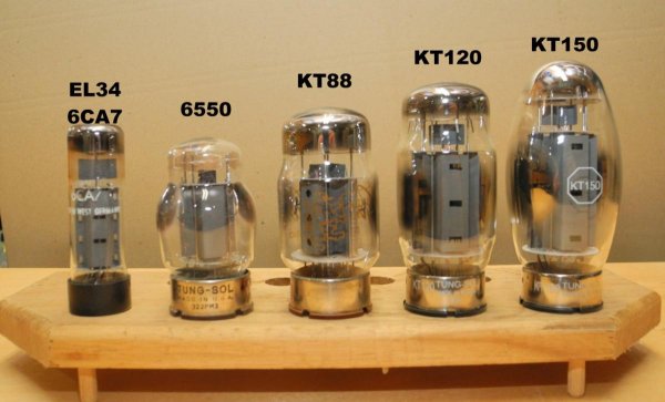

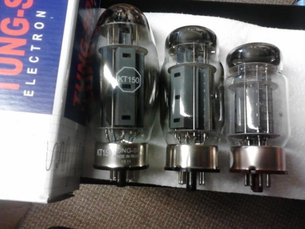

One thing for sure, the KT150 is much larger than the KT120. Just looking at the innards of a VT200 over at arcdb.ws I would think you'd have a hell of a time fitting KT150s into that space. Those KT150 footballs are pretty damn big.
