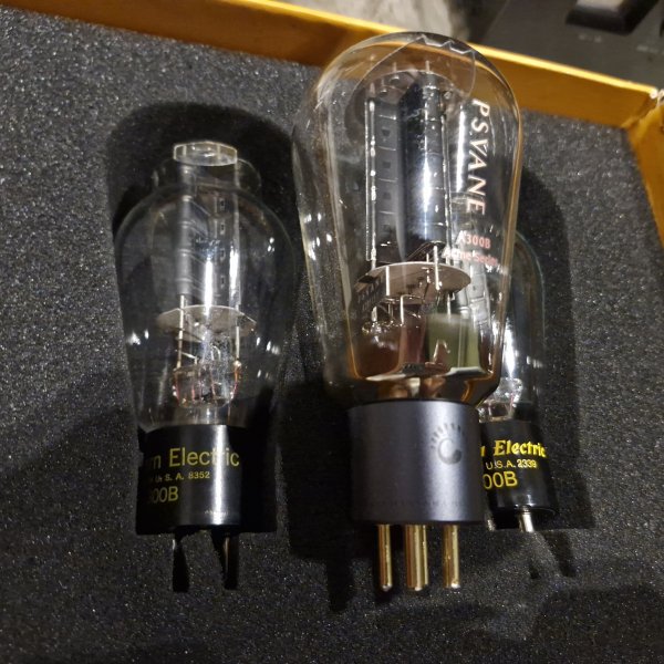

I have tried full music 300b, psvane we replica 300b, psvane we replica 300b+, psvane acme 300b and then the new production we 300b. Each step was a step upwards for me however between acme and we there is a catch and one can choose one over another. Acme is great and has very good top end, silky yet extended, a floaty feeling but new we has better midbass attack and better midrange holography and tone yet the top end is not as silky or extended sounding. When I heard new we 300b, there is nothing missing from the top end, it is just that the acme sounds more special there, like the difference between a 45 tube and 300b, acme 300b top end sounds more like a 45 tube in a good way. Overall, I preferred the new we300b and it has been getting better especially in the first 50 hours, stabilized and good sounding.
I've Western Electric 1983, 2023 and Psvane Acme 300B. The Western Electric built their legend and the Acme 300B sound not even close to them. The WE 2023 pair sounds very clean, sparkle and super crystal clear while WE 1983 pair sounds kind of classic sexy. The Acme ones sounds sparkle but not as clean as both WE 2023 and WE 1893. the Acme 300B sounds a bit of classic but not as sexy as the WE 1983. The good thing about Acme 300B is they cost much much less but does enough good things.

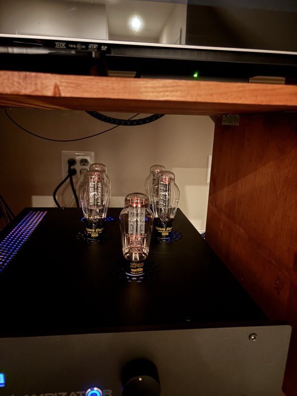

Just put my quad back in- wow, nice to be back home for awhile .
Really- I forgot just how good these sound. Midrange rules. And the punchy bass and nice delicate treble -
Good thing I have many thousands of hours left
