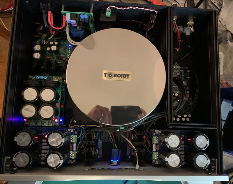

I've been using a pair of DIY Purifi monoblocks for the past few weeks and have been very pleased with them. I spent a while yesterday comparing them to my Parasound JC5, and I think they are comparable. The JC5 is slightly warmer sounding and a tiny bit smoother in the midrange. The Purifi amps have a bit wider sound stage, and a little more energy in the mid-bass. Overall, I could live happily with either.
My amps are a bit different than your typical class D amps in that I have a large linear power supply (1500VA transformer, ~200,000uF of filter caps). I'm currently using the Neurochrome input buffer, but I have a pair of VTV triode buffer boards with Weiss discrete op-amps that I am planning to install next weekend (waiting for a couple of connectors).
I had a pair of Nord NC500 monoblocks in 2019 (tried both Sparkos and Sonic Imagery input buffers) and I was never quite happy with them. They were very clean and detailed, but were not engaging. I never felt like listening to them for more than a short time. My system has changed a lot since then, so I don't know if it's the Purifi modules vs Hypex, different power supply, different input buffers, or other changes to my system.

Did you buy all of the components from Purifi and put the amplifier together yourself (like old-style Heathkits), or did you buy just the amplifier modules and you fabricated or sourced the beautiful case work and related components?
I bought just the Purifi class-D modules from Purifi. Everything else was sourced from various other suppliers. The cases were custom fabricated by Modushop in Italy (purchased through the DIYAudioStore.com site). I'd be happy to provide more detail if you're interested.

The Toroidy transformer has 2x45V (15.6A each), and 3x15V (2A each) secondaries. This is a custom Audio Supreme model.
For the high voltage rails, I used two Universal Power Supply boards from DIYAudioStore.com. These are stacked with the first feeding the second. Both of these boards have the resistor bank populated, so the supply acts as a CRCRC: 13,600uF -> 0.5ohm -> 33,600uF --> 0.05ohm -> 20,000uF. This is for each of the two rails. On my house mains, these deliver just under +/- 70V rails.
For the low voltage voltage rails, I used two PCBs I bought from Jim's Audio. These are also stacked and daisy-chained. Since these boards aren't set up as a CRC supply, I used a resistor in between the two boards to connect the output of one to the input of the other, so these have 13,600uF -> 1.5ohm -> 13,600uF for each rail. These +/- 20V rails feed a linear regulator on the buffer board.
For the gate drive (15V referenced to the negative high voltage rail), I used an Omega11 discrete regulated power supply board purchased from AMB Labs.
All the components for all these boards were purchased from Mouser.
These supplies power a single channel monoblock, so this is replicated for each channel.
