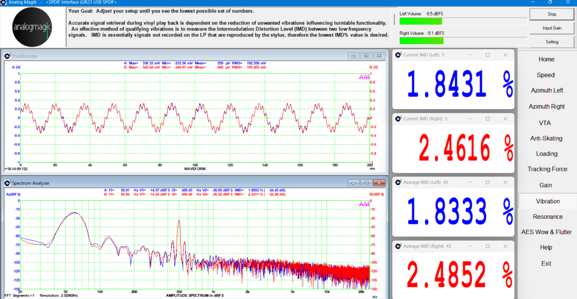

But before I get to that, let’s look at the AM v1 Vibration measurement. The guidance is that anything between 1.5% and 3% is considered good. In my case, unless I move into other forms of isolation, the best I can do on my solid concrete floor plus a deadening layer plus a rug underlayment plus a close pile rug, on which is my 260 pound turntable rack with columns filled with sand and lead shot, on which is a 3” thick maple shelf spiked to the rack, and finally on which is my turntable with pneumatic resonance tuned feet, is a vibration value distortion of 5%. According to the AM info, there is no tonearm or cartridge tweak I can do to make this better. Let’s for the moment consider it the baseline and move on to VTA.
My arm has what I consider to be a reasonably effective VTA on the fly adjustment capability. I normally mount cartridges initially so that - depending on whether the bottom of the cartridge has a flat edge or the face is a flat 90 degrees, I use eyeballs plus a 4 axis laser level (accurate to well with a fraction of a degree at these short distances) to make sure the bottom of the cart is flat relative to a known surface (like the SMARTractor baseplate). From there I can use VTA to do what I need to do.
After this long winded lead in I’m finally getting to my point. No matter what I do, I can’t get the VTA distortion readings to vary by more than a fraction of a degree around (depending on the arm I use) 12% or 14%! I can raise the VTA vernier to get a ridiculous arm angle. Virtually no change. The right and left channels are within a fraction of a degree to each other, so the “presumption” is it’s not a zenith issue. I’ve had this problem ever since Day 1 with AM. I’ve gone through 3 or 4 TT iterations over this time, with at least as many arms and carts. Single belt drive, multiple belt drive, rim drive, replacing the bearing with a high precision Silicon Nitride ball, direct drive… AM says that numbers above 5% are essentially useless as a measure. I just can’t seem to get a handle on what’s behind this. There’s no way I can begin to use this for zenith given what I’m seeing.

What is unknown is what (as an example) the Vibration IMD numbers (using the VTA track) mean if they appear to be ridiculously high. Even if a record were out of round, how does the degree of “out of roundness” affect the numbers? Without floating my turntable in a static warp field, I’d say it’s pretty well immune to air and structure borne vibration. How am I getting double digit IMD numbers and have that not show itself in any audible way by any audiophile who’s heard my system during record playback? I’m surrounded by other vinyl enthusiasts who have been at this game as long as me, if not longer, many with systems far more costly than mine. To a person they consider my vinyl playback among the best they’ve heard.
I just don’t get it.

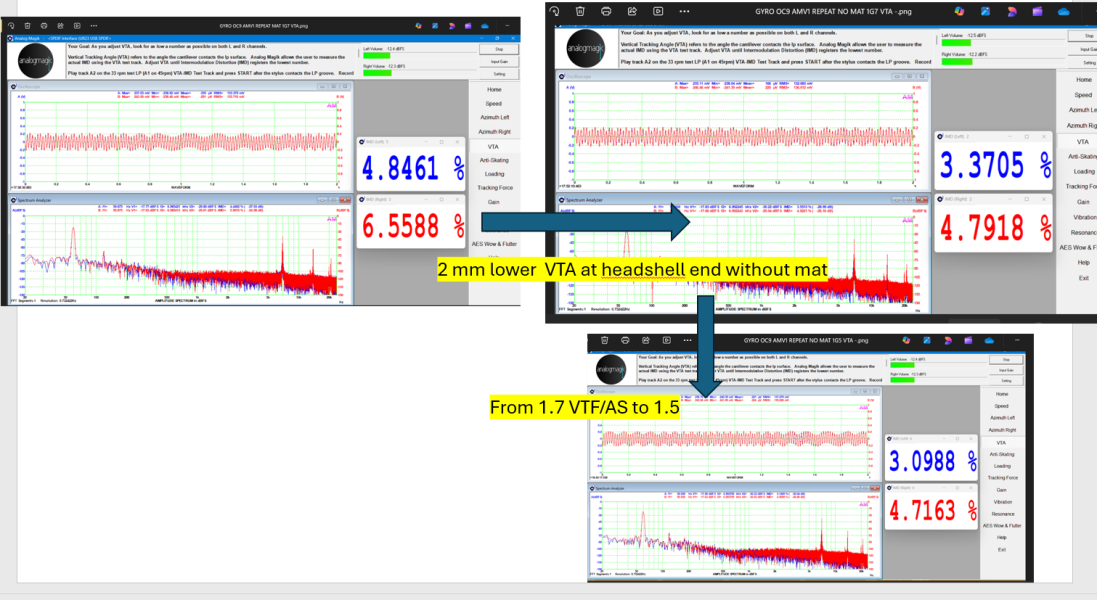

2MM diffrence in VTA and 1.7g VTF to 1.5 VTF. AnalogMagik V1 records and software
My AM V1 vibration data looks like this
The
The Vibration numbers I do not bother about,they are not influenced by any vibration or isolation efforts
