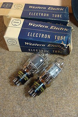

So I have been rolling rectifier tubes in the Allnic H5000 DHT phono for the past couple of years. I have tried virtually all GZ series NOS tubes including GZ32, GZ34 and GZ37. Of the GZ series, the GZ37 were the best overall. Then came the Phillips 5R4GY Phillips (small bottle) and Jan RCA 5R4GY double bottom getters from 1945. These tubes are my favorite now supplanting 1950's RCA and late 40's Ken Rad/National Union 5U4G's...my favorite prior to my double getter 5R4GY's. I thought they would be the end of the road until I received today...the Holy Grail Western Electric 422A nos from 1960. Hopefully these will be the end of the road tube. They should be for the price of admission. If they arent and I prefer my double getter 5R4GY, these will go up for sale if anyone is interested.
