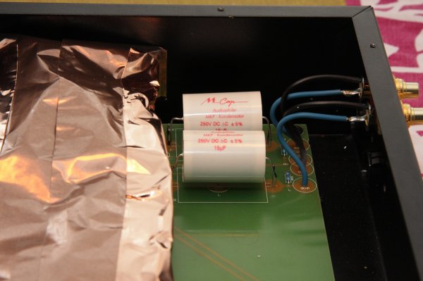

Since there have been recent discussions about tuners and fuses, below are some mods that may be of interest; the tuner's have resulted in truly astounding sound from FM:
The AckFuse - basically thick copper foil from a Mundorf inductor used to bypass the fuse... yes, I am done with fuses, and don't use aluminum foil... I decided to do this after realizing that my amps' fuses were fairly warm after extensive high-power sessions, which indicates excessive and undesired resistance (ditto with so-called audiophile fuses like the HiFi Tuning).
The Etude tuner's innards, with completely shielded RF section and bypassed coupling capacitors in the output (1st picture), eventually replaced with higher-value Mundorfs (2nd picture) as there was sufficient DC (the reason Magnum Dynalab put them there); the improvement in very low-end extension and tightness - as evidenced with various organ pieces - is staggering
