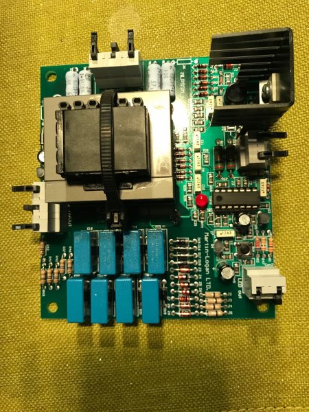

Back in business, after 6 long months of distortion and reduced acoustic output - new panels and power supplies; step-up transformers are in perfect condition, really high quality too. The new power supplies are obviously quieter as well.

Regarding the power supplies, I haven't seen so many diodes in a PS before, there must be upwards of 25 in there, some even between the polypropelene capacitors.
It looks like a classical Cockcroft–Walton voltage multiplier, as used in most electrostatic speakers. See https://en.wikipedia.org/wiki/Cockcroft–Walton_generator . A lot of the diodes are Zener's - to give some kind of regulation to the HV.
For detailed analysis of this type of ML board see : http://www.martinloganowners.com/fo...37b756894de981&p=178127&viewfull=1#post178127

Great discovery micro! Thanks for this. Let me copy this circuit diagram over here then, it's from ML; I need to study it in more depth
