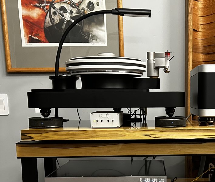

I have used AV Room Service EVP's for several years. They have performed effectively on all of my electronics including the TT (Ars Machinae M1, pictured below) which has a tripod configuration for the feet.
The price certainly has risen but they do work better for isolation than any other passive device I have tried. In that regard, and in my system, the price is in line, imo, with brands they outperform.

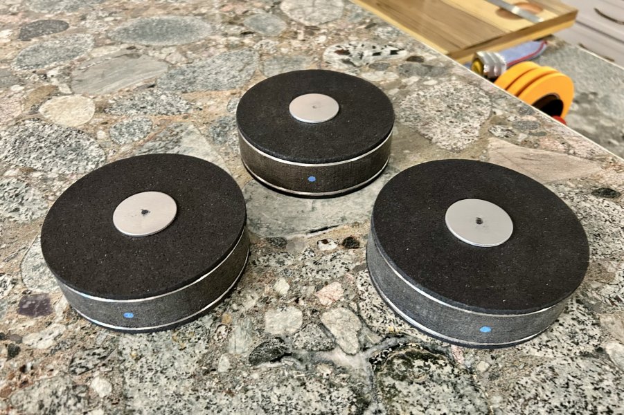

If you do go in the EVP direction, I would recommend stainless steel discs for any EVP used with pointed feet (like the RevOpods that came with my TT). First, the discs aid in centering the feet on the EVP and secondarily, they prevent dimpling/crushing the EVP by more uniformly distributing the weight of the TT over a larger surface area. Norman at AV Room Service confirmed (as has my experience) that EVP performance is not impacted by the metal discs because EVPs are agnostic as to what material is above or below them. I included an image of the three (3) EVPs I use on the Ars Machinae M1 which weighs ~ 80 lbs.
AV Room Service sells the discs, but I have also located them on Amazon (I do not believe they are the same source used by AV Room Service, but they appear to be nearly identical).
