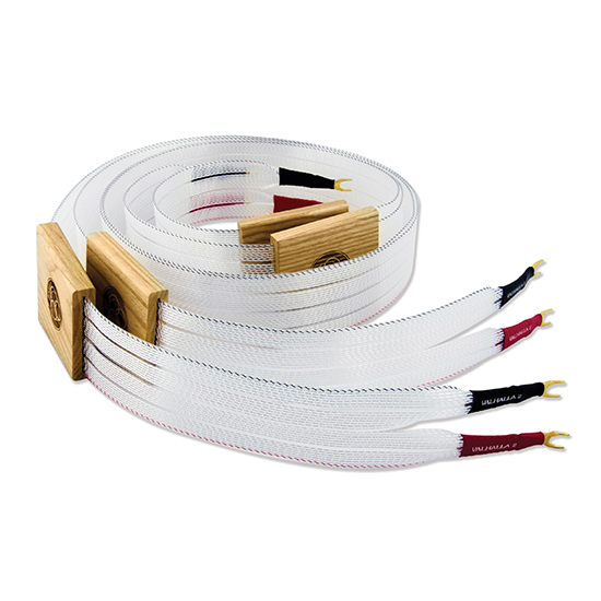

Nordost uses a similar approach and have 0.125?H/ft inductance. Plus/minus conductors are adjacent but are in a flat (litz like) arrangement to minimize skin effect and do not rely on side by side +/- round wire configuration for reduction in loop inductance. Oh and they certainly do not roll off highs.

In the Nordost loudspeaker cables, the Plus & Minus conductors are permanently molded close to each other (looking at the closest strands). So they may have reasonable loop inductance (I'll have to find the old equation book).
