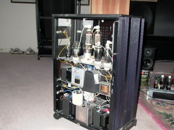

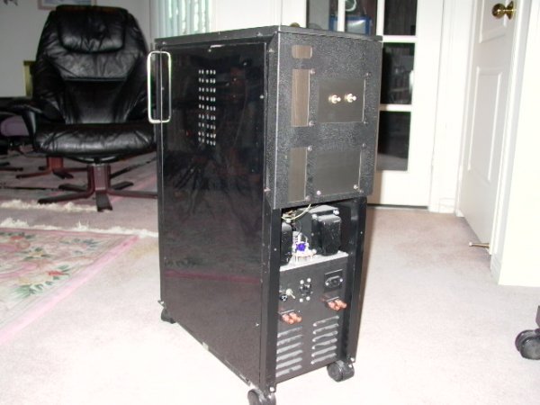

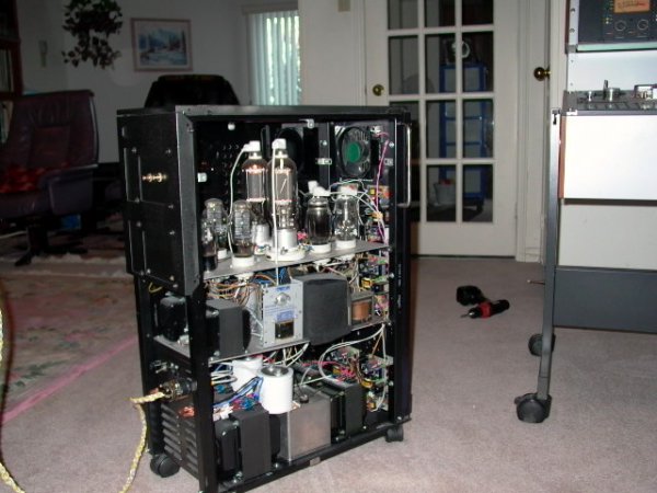

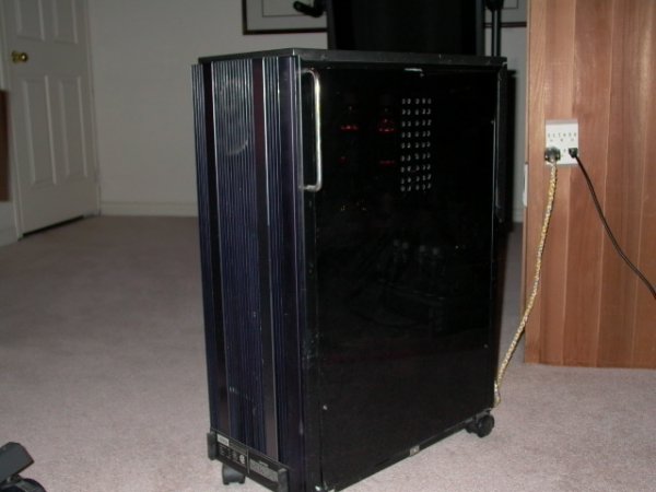

No wonder it don't like a normal topic in DIY because Steve moved it to DIY, no shows no pictures just talk, I did a monster tube amp on wheel because it over 200 lb but the out put only 50+50 W
tony ma

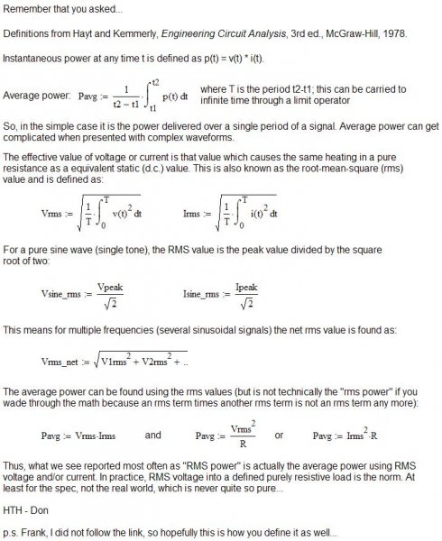

Pasted from Mathcad (a math program used to get pretty integral signs):
Note that the peak-to-average ratio in music is around 17 dB, meaning you need 50 times the average power to avoid clipping the peaks. For movies, I have seen as high as 30 dB, and other research (which I recall but cannot site off-hand; you want it, you find it) indicates live music may be similar. 30 dB is a factor of 1000, meaning you need 1000 W to not clip if your average power is only 1 W. Assuming your speakers (and ears) can take it...
Aside: You can think of the integrals as calculating the area under the curve of power over time.
