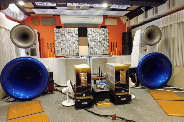

Hello QuadDiffusor,
Nice to talk with a fellow HK audiophile in WBF!

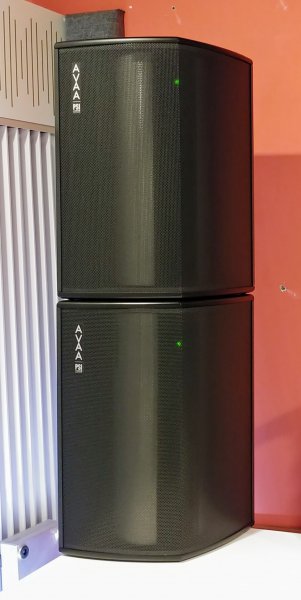

My friend Paul is using 4 AVAAs in his music room, placed at the two front corners :
Even though his room is more than 500 sq ft in size, it's not easy to tame the two subwoofers (the whitish structures along the frontwall) each of which has dual 18" drvers!

My gosh, are those the big crazy rare and pricey Zanden monos that were demoed at the Audio Exotics super show in 2017? I'm impressed.
The instructions for the AVAA talk about keeping units separate, but one review does discuss the positives of having a pair stacked in this way, so this obviously has merit.
No AVAAs on the rear wall in this room w Cessaro Gammas?
Yes, those standing in the middle of photo are the Zanden Chouku monos. The owner is using it with the Zanden Chokoh preamp and Jinpu phono amp of the same series too.
He didn't put AVAA on the rear wall.
The room is quite long, about 36 ft and the listening seats are quite far away from the rear wall.
CK, I too have a long room, 38' on one side, 48' on the other to incl L-shaped alcove space.
If my experience was to match your friend's, I would as he does stack two-high AVAAs on my front walls in corners.
My side walls are just short of 4' high, so two stacked would fit perfectly.
However PSI don't recommend stacked AVAAs, indeed advising units to be kept separate, so this is v interesting.
