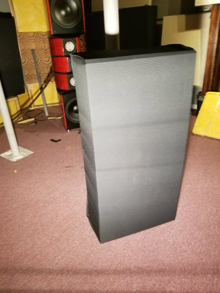

These are free-standing broad range bass traps by GIK acoustics.They are 2’ x 4’ x 7”.Like the Real Traps, these do a very nice job helping to clean things up in the range of around 60hz – 200hz. I have two of these and paid $175 for each. I would sell them for $100 each.
DIY Free-Standing Bass Traps with scatter plates – Similar to the GIK Monster Traps, but are 12” deep (they are 2’ x4’ x 12”), which makes them a bit more effective. I built scatter plates for most of the ones I built. They are covered with the same acoustic/fire-retardant fabric I have used for my other bass traps. I have 8 of these and would sell them for $75 a piece.
