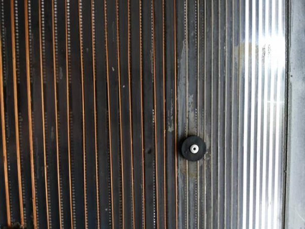

Around 2015, I heard some flapping in the bass of the R speaker and some mid range distortion on the L speaker. A friend immediately told me the wires have been detached from the diaphragm of the planars and I sought out an expert repairman who was very familiar with Magnepan speakers. I had to watch him 'undress' the 2.7s and it was quite a hell of job to do. Those tight cloth socks are fastened with countless staples below the frame. We carried it out to the garage and he cleaned them first, so much corrosion had built up in 2 decades, and the speakers were in a sealed air conditioned room with no windows for sunlight to hit them.
First time for me to see a 'nude' Maggie. And I saw the wires delaminated from the planar's diaphragm.
Above, we can now see the bass, mid and ribbon 'drivers', from left to right.
Corrosion all over the wires had to be cleaned with a special liquid. And a special glue had to be used to fasten the wires all over the panel.
There were no 'exotic' connectors or terminations used. The wires could even be ordinary hardware wires. :)

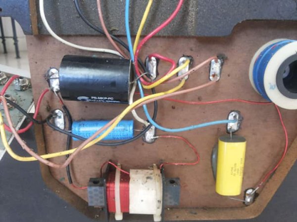

After the cleaning and the re-gluing (for about 3 hours), the speakers were pronounced ready to go again, but after a year, that black capacitor below died suddenly (loss of highs in the tweeter) and it took some online help from a user group member to help me diagnose the problem - ruling out fuse, connectors, wires, etc. It was a Solen 20uF cap and I had to buy a pair to change the other side as well. And here they are again today. singing in its 25th year from its day of manufacture. :) I
I should imagine the parts used in the recent 3.7i and 30.7 to be much much better. :D

Woah, that looks really bad :eek:
The words "faulty design" or "constructional defect" spring to my mind :oops:
Old Apogees had their own "issues" like crumbling foam that causes the dreaded "Apogee buzz" but I have never seen an old Apogee looking THAT bad :rolleyes:
Let alone without sunlight and air condidioned o_O

Long time behavior of glues and foams was the Achiles knee of several speakers of the 70's. Although most speakers can be easily re-foamed with new surrounds, re-building panels is a more laborious operation . My otherwise perfect ELS63's need re-gluing of the stators - the perforated plates need to be glued to the frame. This operation will need the complete disassembly of the speaker and is a pain to carry. In this aspect the ESL57's were much intelligently designed, a 55 year old pair was recently still performing as new in my room after I replaced one leaky PCB of the HV supply.

Phil,
I have to admit these are shocking pictures; my long-gone MG IIIa's must have looked the same, I assume. You may want to replace that yellow capacitor too, which looks like a Bennic, plus what looks like that blue electrolytic
Reactions: jadis
Tasos,
Yes.. The tech man told me to brace for the bad sight maybe due to our humidity all year long as he had seen some bad ones too. The more seasoned Maggie owners say the caps last really long and I will get there somehow. Right now the cloth is all sealed and it's tough to open it up again.

Looks fairly typical to me, a little worse due to the humid environment (I assume). My MG-IIIa's were still going after 29 years until I retired them a couple of years ago (still have them). As a former tech I have re-glued many older Maggies (and replaced many ribbon tweeters). The latest versions use all QR panels IIRC so should hopefully be less susceptible to delamination.
Conventional speakers and ESLs aren't pretty after all that time, either.

Air conditioning does not get rid of all humidity. Especially when starting from such a high point. In fact, as the AC is cycled, it can condense moisture out of the air onto other surfaces (like speakers, especially the cool metal wires in them).
IME humidity has little to do with delamination though it does increase the chance for corrosion (the green film). Sunlight and it's UV rays are death to both the glue and the panel material so again IME are bigger players in longevity. Smoke is also not a good thing (though a bigger issue for early ESLs). Back "in the day" it was my sad duty to tell folk that placing their panels against windows was not a good idea. The marketing answer was "why block those nice windows?" and the engineering answer was "why kill the life of your speakers?" Cone speakers are also sensitive to light but usually face away from the windows so less an issue.
